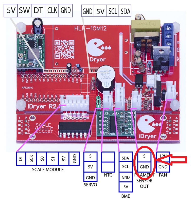

Hi everyone. Can someone tell me what this connector is for? As I understand it, it isn’t used on the X. But I’d like to know what it’s for.
Or is it actually used after all?

It’s for something like a filament runout sensor. It works based on the spool weight.

So what exactly do you connect to it? An LED?

I don’t remember if it’s in the documentation​:thinking: It connects to the printer board like an endstop and gives a high signal at a certain configured remaining filament weight. It works the same way as a filament runout sensor.
