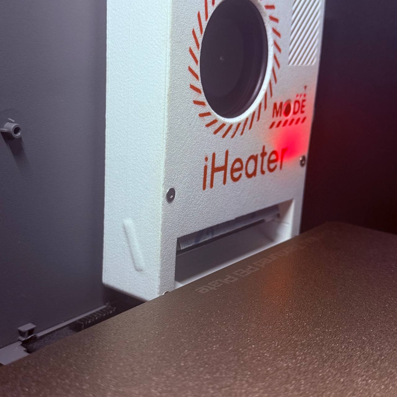

Too high output temperature and case warping
By the way
How can I limit the outlet temperature?
I just checked it with a thermal camera
It’s about 118 degrees at the outlet
And the housing is starting to deform
Or is that how it’s supposed to be?
This stripe keeps getting bigger every time

Well, the config has the heater temperature in it. Change it to whatever you need.

I’m selecting 60 degrees
But at the outlet it shows about 118

Well, we have two temperatures. The one we want, and the one we’re heating the heater to. If we want 60 and the heater is at 60, then we’ll never actually get 60.

I roughly understand that
But I thought the difference would be a bit smaller
Like 20-30 degrees
That’s just my guess
If that stripe on the housing doesn’t keep getting worse and nothing leaks out
Then that’s good

If it has already started, then the filament might not be up to that temperature. I’d lower the allowed heater temperature in the config and then go by the actual chamber heating readings.
