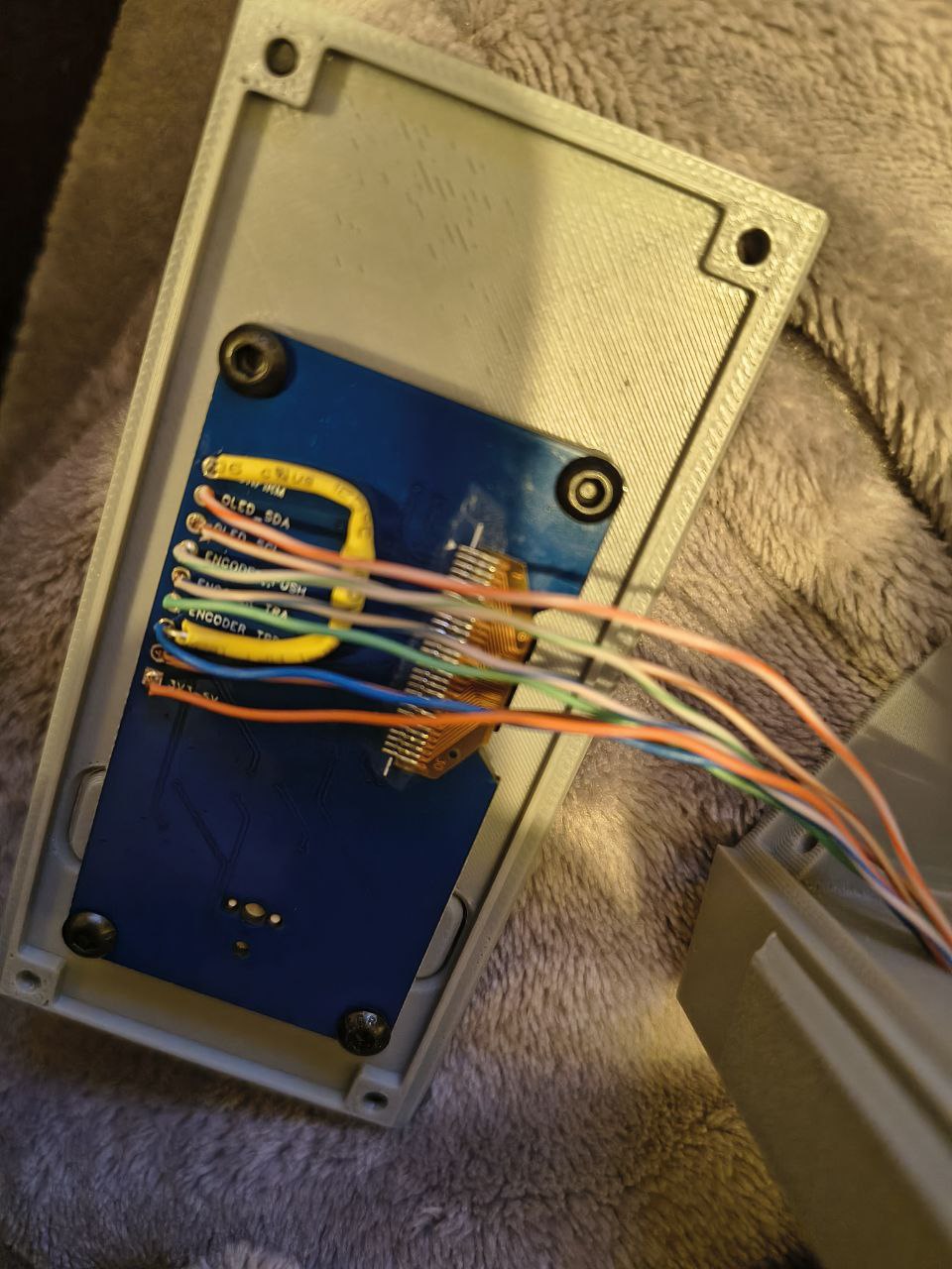

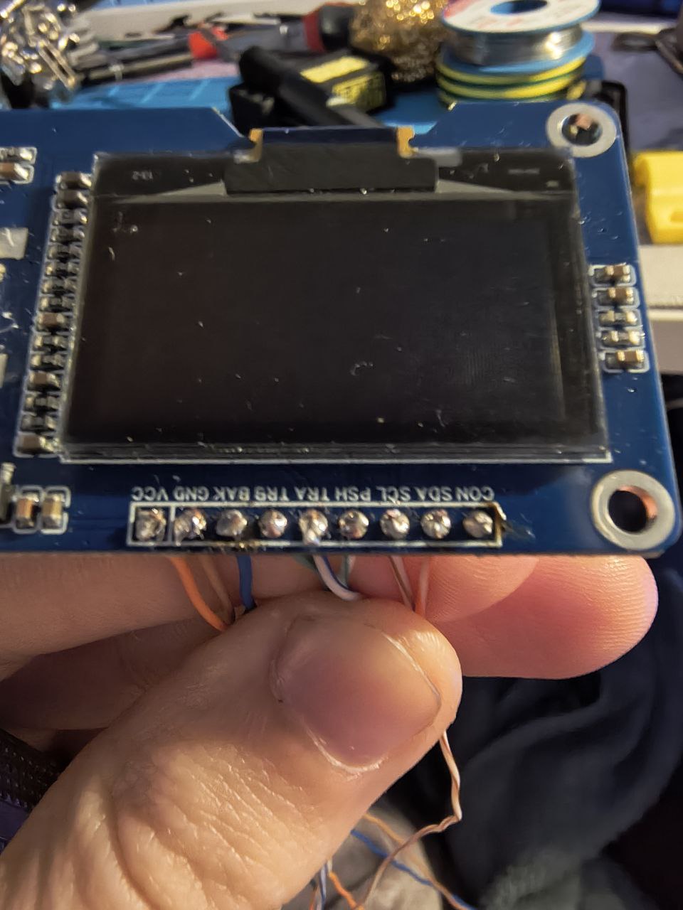

Hey. My soldering iron finally arrived. I soldered the display on (checked continuity — no shorts, cable is fine). Hooked everything up, flashed it through the web UI, waited. When I power it on, the display shows 0 reaction, the LED on the board lights up, the servo buzzes once, and all 4 indicators blink red.

Got a photo of the screen and the soldering?
фотка экрана есть и пайки?
It’s only the second time I’ve held a soldering iron..
Паяльник второй раз в руках..

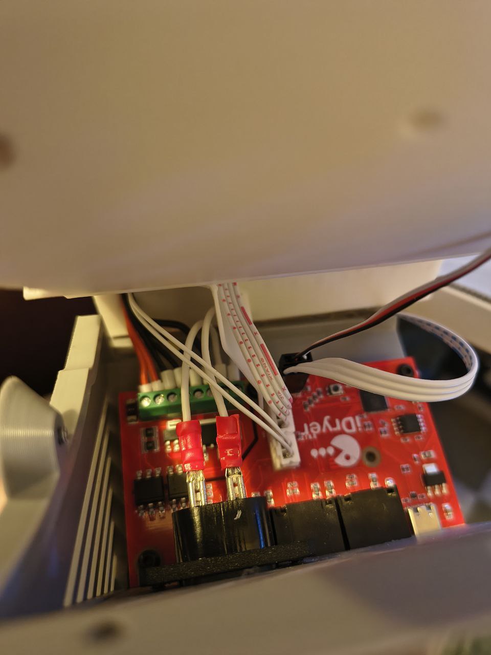

And which port did you plug it into? It needs to go into U4
и в какой порт воткнул? нужно в U4

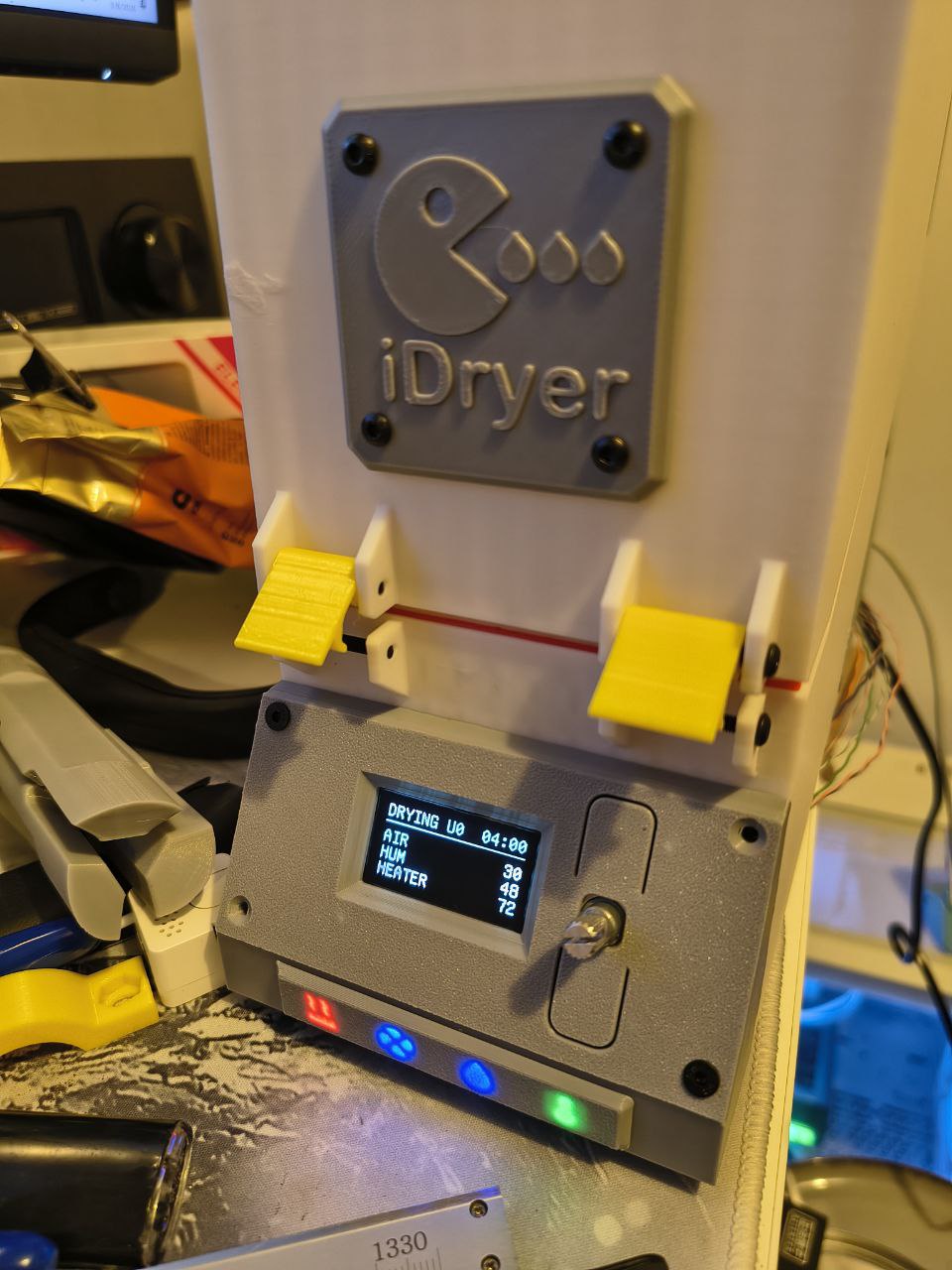

Alright, the display is working now. I could’ve guessed which port from the cable channel
Absolutely awesome!
Так, ну дисплей заработал. По каналу для кабеля мог бы догадаться в какой порт
