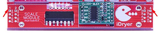

I still haven’t figured out the scales yet, tomorrow I’ll keep digging into it. Here’s what I tried: there are gaps, I also tried putting extra washers under the spool holders in addition to the spacers; during assembly, on the sensors themselves (the long metal ones, don’t know what they’re properly called), there are 2 washers like in the video. I measured it — there’s definitely more than a 2 mm gap, about 3 mm. I connected the wires correctly, checked with a multimeter like in the video here. The op-amp isn’t heating up, though I only checked by hand. I resoldered the jumper for 10 and 80 hz, that didn’t help either. Now about the problem: I do the calibration, but the weight doesn’t change — or rather, sometimes it shows 1000 grams, but it doesn’t matter whether the spool is there or not. I tried calibrating different spools (from different sides, since I didn’t understand which one is first and which is second). In the end I still couldn’t get it working. I’d be grateful if you could tell me what to check. And yeah, I checked everything that was in the guides. The platform itself is tightened down, no play in it.

you need to place the weight very quickly during calibration. the first scales are the ones closest to the edge of the board

Well, I place the weight when the display tells me to and the countdown starts. Do I need to put it on earlier? Didn’t get the part about the edge of the board)) the board is in the middle though…

it means the connection to the board (where the wires go)

yeah. where the wires from the load cells themselves (the aluminum bars) are connected
nah, you just need to do it quickly. how many kilos are you putting on, and what are you using?

There are markings on the board, and how exactly you soldered them…

just out of curiosity, you can try putting a bit more. and make sure the sensor wires are soldered into 1 and 2, not 3 and 4
ради интереса можно поставить чуть побольше. и убедиться, что провода датчиков запаяны в 1 и 2, а не в 3 и 4
Damn, that’s exactly it, I only just noticed that mine are soldered to 3,4… what an idiot I am (sorry if that’s a swear word).

Actually, better check the little wire bundle from each scale right now, put it together, and label it. So it doesn’t turn out that two wires from one scale are soldered to 1, and two to 2

Now everything is working perfectly, thanks everyone for the help :handshake:
