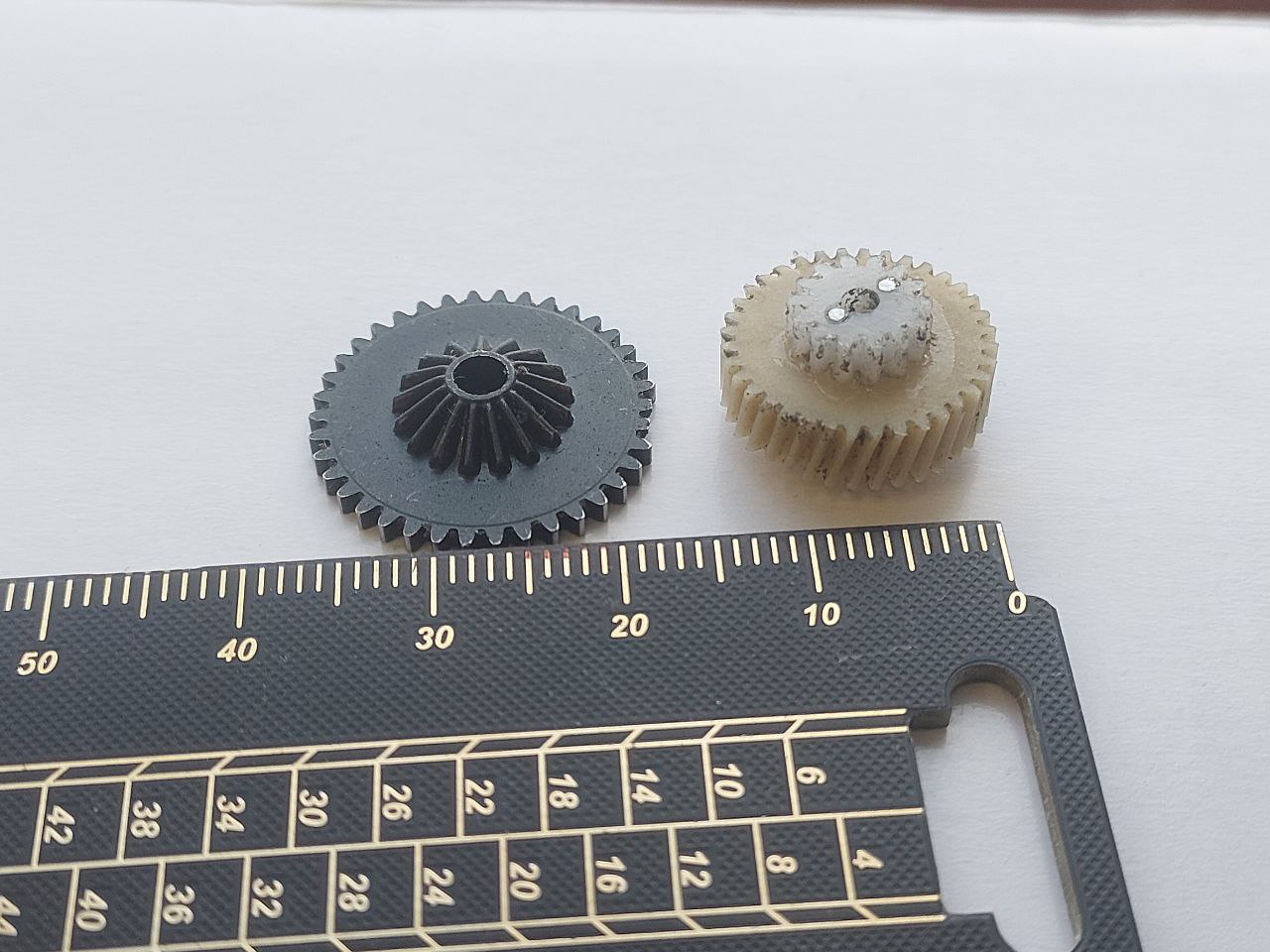

I need to print some gears, “lightly loaded” :grinning_face_with_smiling_eyes:
I’ve got a spool of nylon from HTP, composition unknown, the internet says it’s some kind of PA6 and PA12 blend, and that it’s not really suitable for gears :face_with_raised_eyebrow:
Something like this.. the one on the left is silumin, a couple of teeth got ripped off :flushed_face:

Chamber at 60–65, brim, 6–8 mm³/s flow. You don’t need part cooling at all here, so that’s it)
And the tests are the same as for other plastics: tower, flow, PA

One more question: you can get 6–8 mm³/s in different ways.
What’s better: “thinner layer + higher speed”, or “lower speed, layer height according to the nozzle diameter”?
I’ll be printing with a 0.2 nozzle, layer height can be from 0.05 to 0.1..
I don’t have an active heated chamber, just an enclosure cap.
