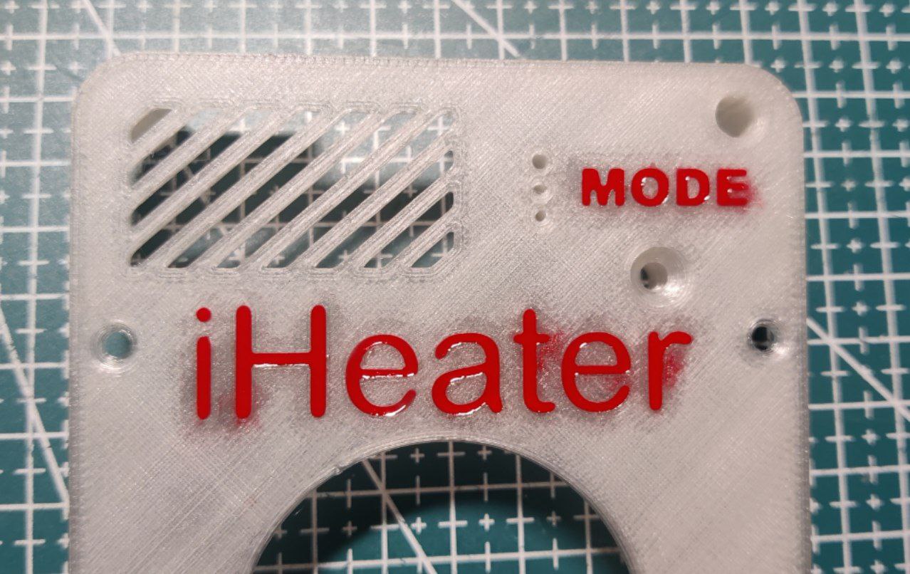

Photopolymer in syringes: too thick, leaked inside, second attempt worked better
I once picked up some photo resin in syringes like this just to try it out
https://ozon.ru/t/1W0ZDrQ
In practice it turned out to be really thick, and the color was pretty much “meh” too — for example, the red one
So I thinned it a bit and added some pigment for photo resins, a few drops…
Though I diluted it too much (well, so it would have time to spread evenly) and didn’t take into account that there’s still a bridge there, and no solid top layer… And, just my luck, I mixed them up and grabbed the “combat” cover (I mean the proper finished one, not the “underprinted” one)… But it came out interesting. Looks like it still would’ve been better to first go over it with the transparent thinned resin as a primer — that would’ve sealed it, and the pigmented one would’ve spread better too

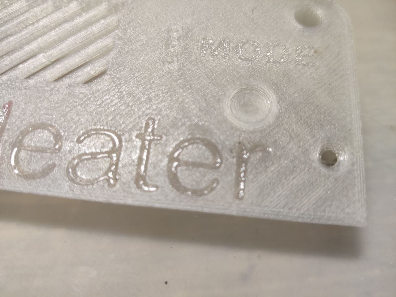

So it flowed inside then? :scream:
You should also add a bloody handprint or drip some drops on it.
If anyone asks why it’s stained and has drops on it — just say: serves them right for sticking their fingers into the fan
Он внутрь втёк получается? :scream:
Надо ещё окровавленный отпечаток или капли накапать.
Кто будет спрашивать почему в пятнах и капли - скажешь - а нефиг пальцы в вентелятор сувать
yep :frowning:
Looks like at the speeds I was printing, the solid infill wasn’t heating up enough and there was under-extrusion. It’s just so rigid there that it’s not noticeable at all :slight_smile:

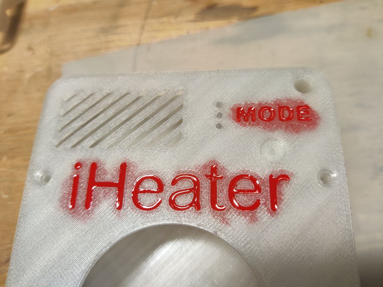

That sucks. But the resin looks really nice on it!
Абыдно. Но лежит полимер очень красиво!
The second attempt is already better. This time I first primed it with clear resin, and only then went over it with the colored one
