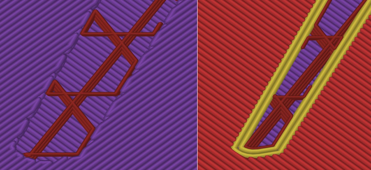

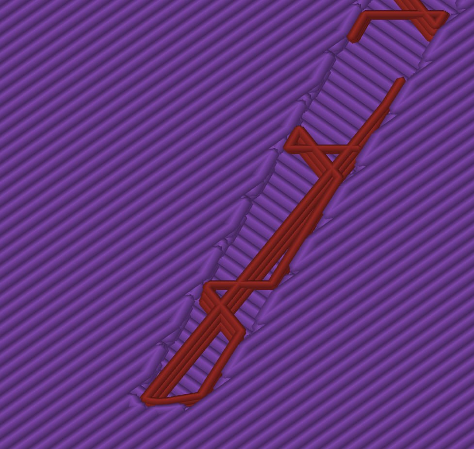

I searched all over OrcaSliser — there used to be a setting somewhere that expands the solid infill or the top layer so there aren’t any gaps where the perimeters meet the top layer. I clearly remember that option existing — either they removed it, or I’m just blind.

Here, there’s a very high chance the perimeters will sag and you’ll get intermittent gaps where the perimeters meet the top infill. With that setting, it would just lay down more of the purple infill, and the perimeters wouldn’t be printing in midair

Found it — it’s called “ensure vertical shell thickness”. Not obvious at all :see_no_evil_monkey: But it affects the whole model and adds extra plastic everywhere :eyes:
