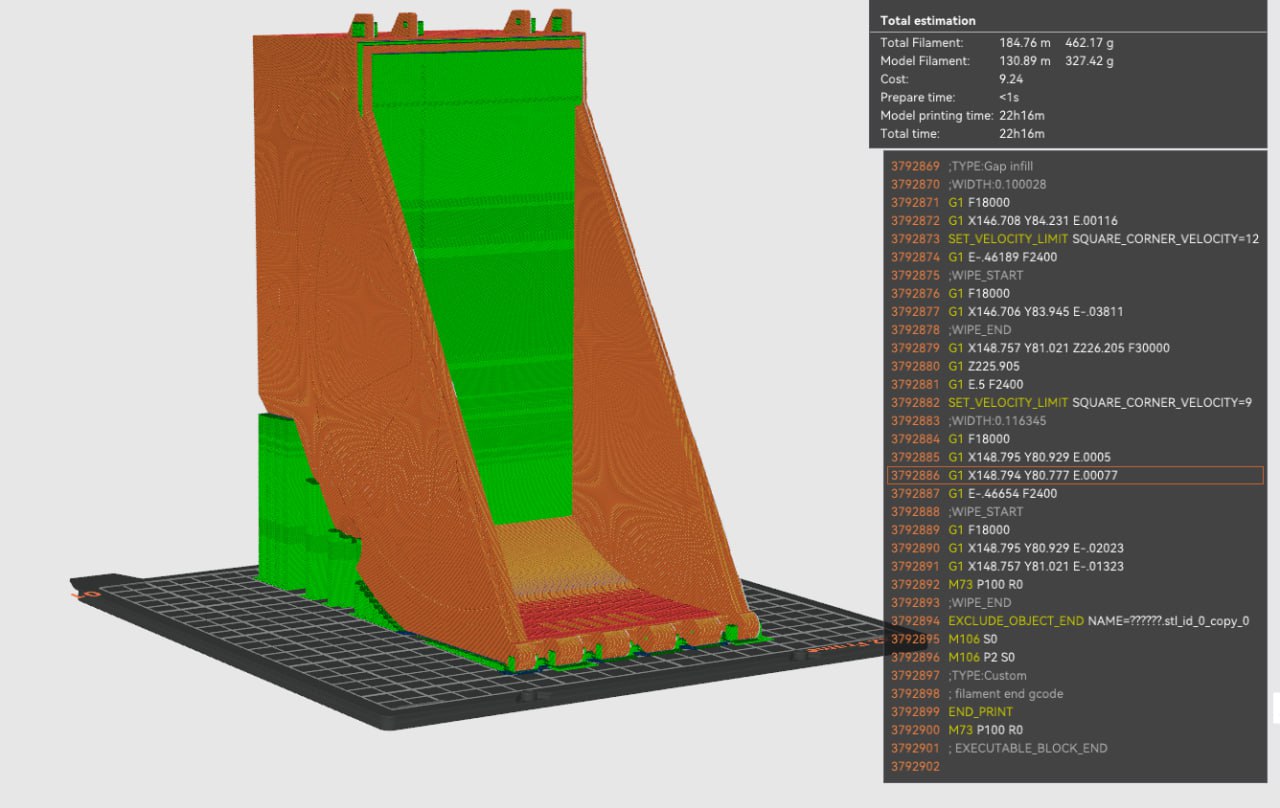

I only managed to place it like this. Somehow it feels really sketchy

It’s better to adjust the coordinates for your own setup here (so it’s best to check the min/max coordinates), in my config it’s something like this:
[stepper_x]
position_endstop: 234
position_min: 0
position_max: 234
[stepper_y]
position_endstop: -0.5
position_min: -0.5
position_max: 221 # 226
And yeah, the K has to be rooted, with access to the configs. And it’s better to use Prusa or Orca as the slicer
Also, in the slicer the area is set to X:230, Y:220
And yeah, worth mentioning that on the K1 for ABS you should set the volumetric flow limit to 8 (or better 5) mm3/s
