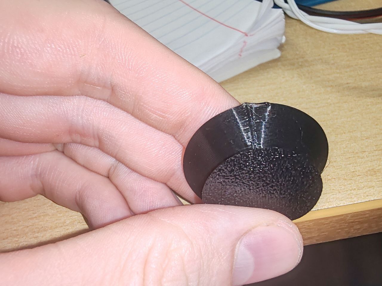

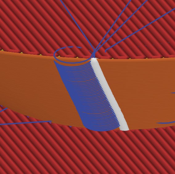

Is there some way to disable these circles? Turning off the wipe doesn’t help
They make it print really badly

z-hop with spiral lift, in the filament settings
