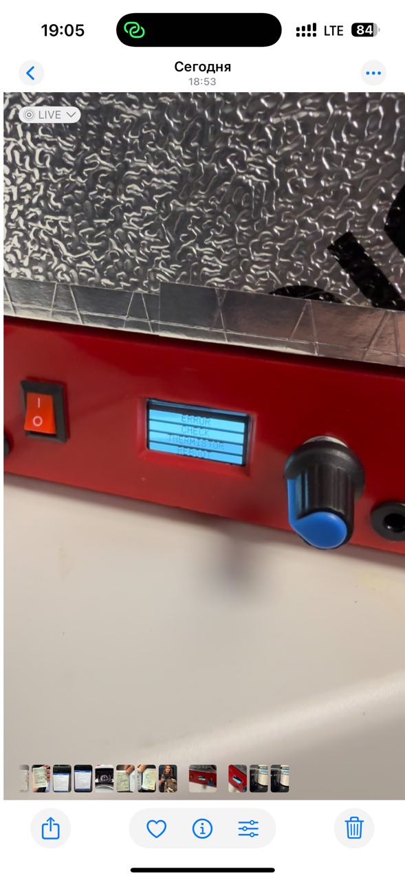

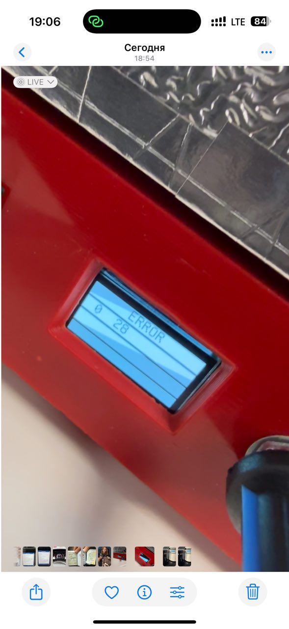

Error 28 in iDryer storage mode: BME280 sensor likely faulty
Good afternoon. I’ve got a problem. In storage mode, error 28 pops up
The humidity sensor never shows less than 15
Could that be related?
Also, the dryer shuts off and beeps
After turning it off and on again, it works.

Strange, and it most likely isn’t related to the wiring.
The temperature read from the sensor is at the minimum
https://github.com/pavluchenkor/iDryerController/blob/c4d1847653e237a8bc3c3afd13745c453881fc36/src/main.cpp#L1737
Possibly a defective one. If so, then this is already the second bad sensor in this batch buy

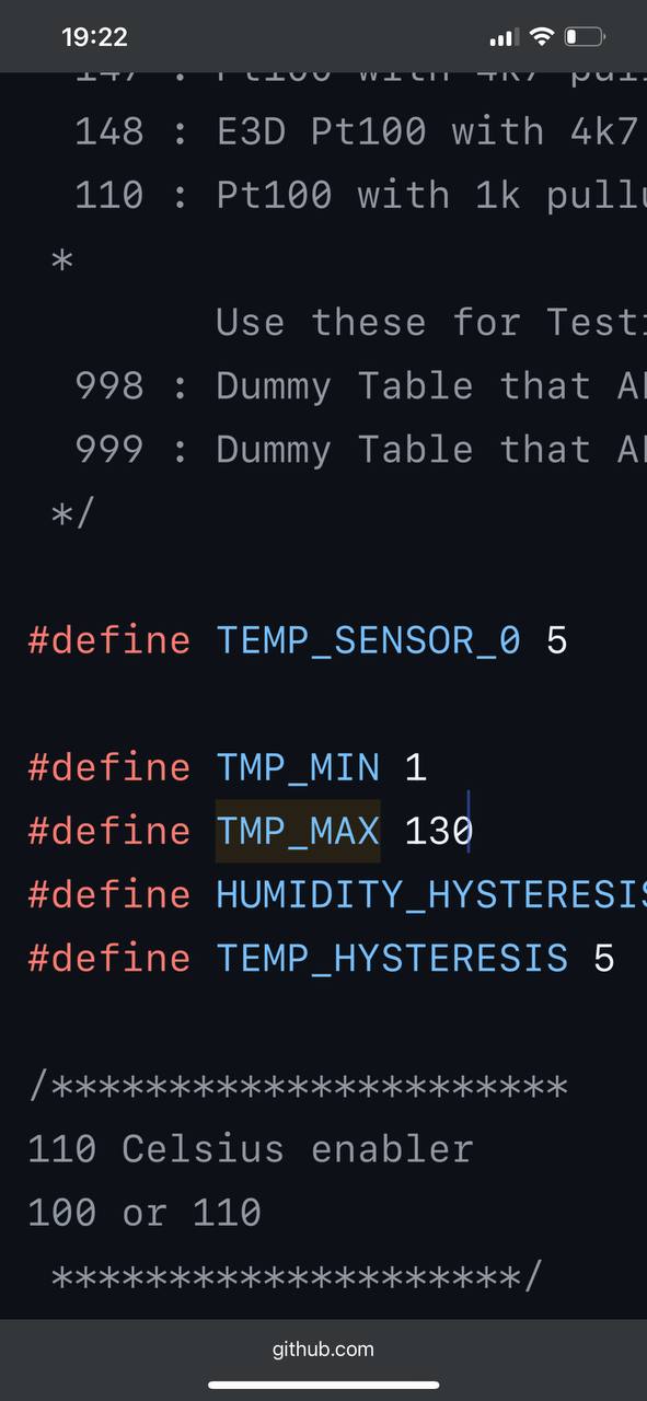

I think the humidity sensor is glitching — because no matter what I do, it’s always above 15
/ Linear Temperature Calibration for BME280
#define MIN_CALIB_TEMP 25 // Regular ambient temperature
#define MAX_CALIB_TEMP CE //!! Do not edit
#define REAL_CALIB_TEMP_MIN 27 // BME280 readings at regular air temperature
#define REAL_CALIB_TEMP_MAX 120 // BME280 readings during thermocouple calibration
if (iDryer.data.bmeTemp < TMP_MIN)
setError(28);
so the error is related to temperature
so it’s less than 27

No, lower than this
Не, меньше этого
then yeah — looks like the sensor is toast
so that means the temperature from the BME sensor is below 1
тогда - да - получается датчику капут
те получается температура с датчика BME меньше 1
