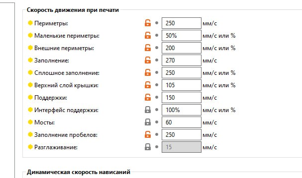

Well, I’m on a K1, and speed is basically flow rate here. I do the outer walls at 30 (so it looks nice and bonds better) and the inner stuff at 90 (to make it faster).

You won’t get those speeds if the flow rate is capped at 5.5.
🇷🇺 Оригинал
Так не будет таких скоростей если расход в 5.5 ограничивается
Well, it’ll cap itself at the maximum flow rate. I just don’t bother with it.

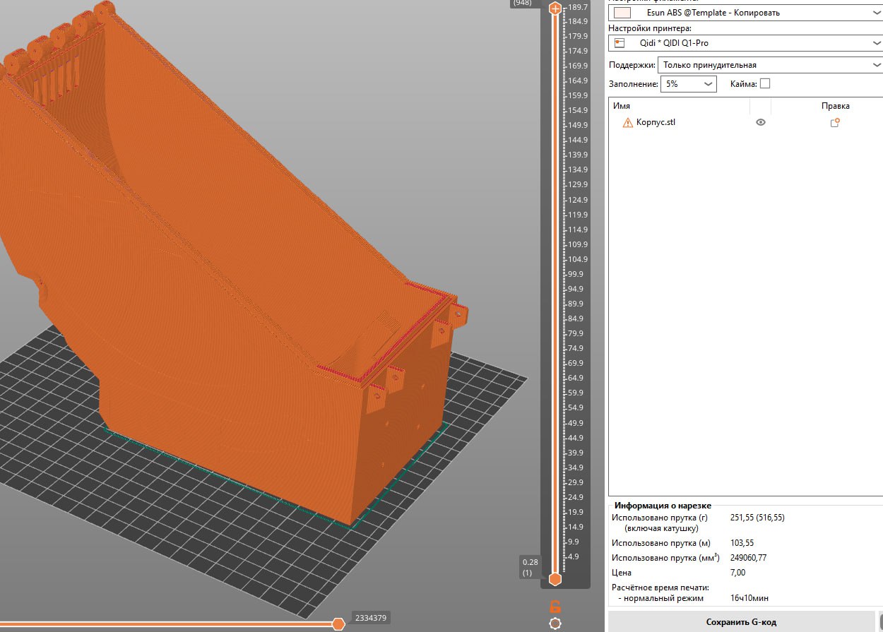

The slicer says 16 hours. But I think the actual time was less.
