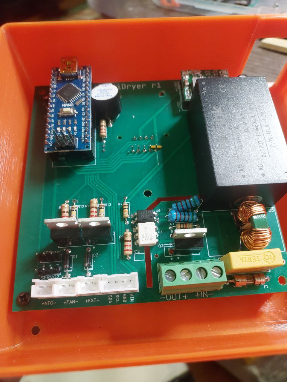

Connecting the thermal fuse and fan on the old iHeater board
So, how was the thermal fuse supposed to be connected? In series with the heater circuit, or to the board in the EXT connector?
Also, the fan has 3 wires, but the board only has 2 pins — should I use the black and red wires from the fan? Leave the blue one disconnected?

There’s a spot on the board for a thermal relay, in series with the fuse — it’s shown in the diagram
Leave the blue one

Could you point it out, please? :smiling_face: The fuse that’s on the 220V input? I don’t see any others.
220V mains into IN
OUT — connect the heater

В in от сети 220
Out- нагреватель поклдчать
Ahh, you’ve got the old board — then yeah, either rig it in series with the fuse or in series with the heater

In series with the heater makes more sense then,
What’s the EXT connector for?

It was meant for something extra at some point

Got it, then no more questions — it’ll stay empty, I’ll solder the thermal fuse in series with the heater
