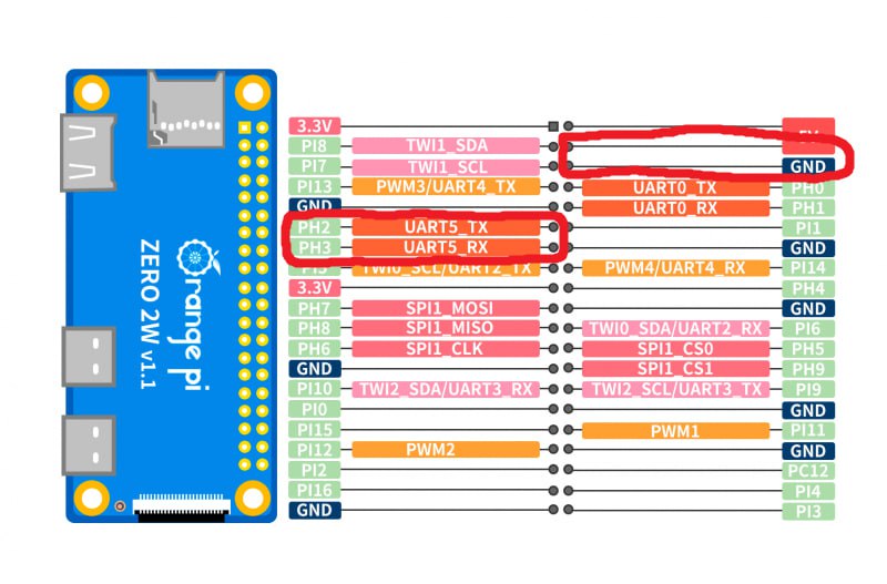

I took the image from the Klipper wiki.
Updated everything, installed KIAUH, flashed the firmware with gpio0/1.

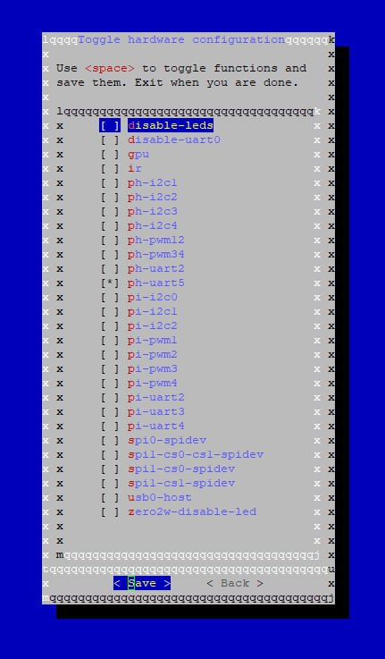

Enabled all UARTs in orange-config.
Connected the unit to the OPI Zero 2W (uart3).
Board RX → OPI TX, board TX → OPI RX.
Checked the connections, from the RP2040 (second and third pin) to the OPI everything is fine.
In printer.cfg I tried all ttySx options, no effect.
In KIAUH, when I search for the MCU and choose the UART interface, ttS0 always shows up.
What am I missing?

So, uart5 should be enabled
Did you enable uart5?
Connect it to uart5 and set the restart method too, why uart3? I posted the screenshots a bit above.

It’s right there in the screenshot :man_facepalming:t2:

Maybe it doesn’t, but people have definitely gotten it working on uart5 (as usual) and on uart0 (though there you need to disable the console debug process first).
