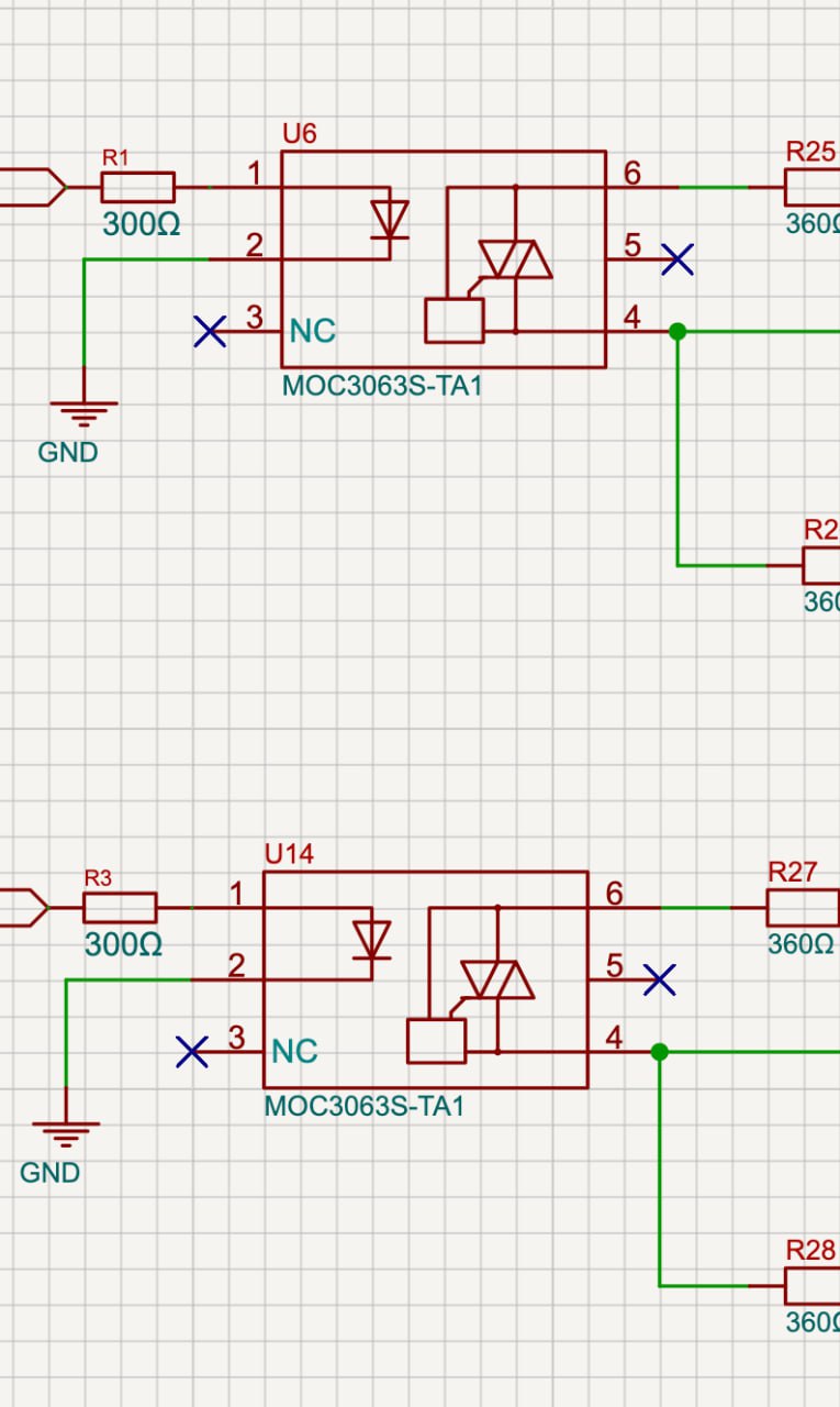

Try this one, but on the board you need to swap the MOC3023 for something with zero-cross detection, for example a MOC3063. At least it works for me

yeah, that’s what it has)
там оно и есть)
