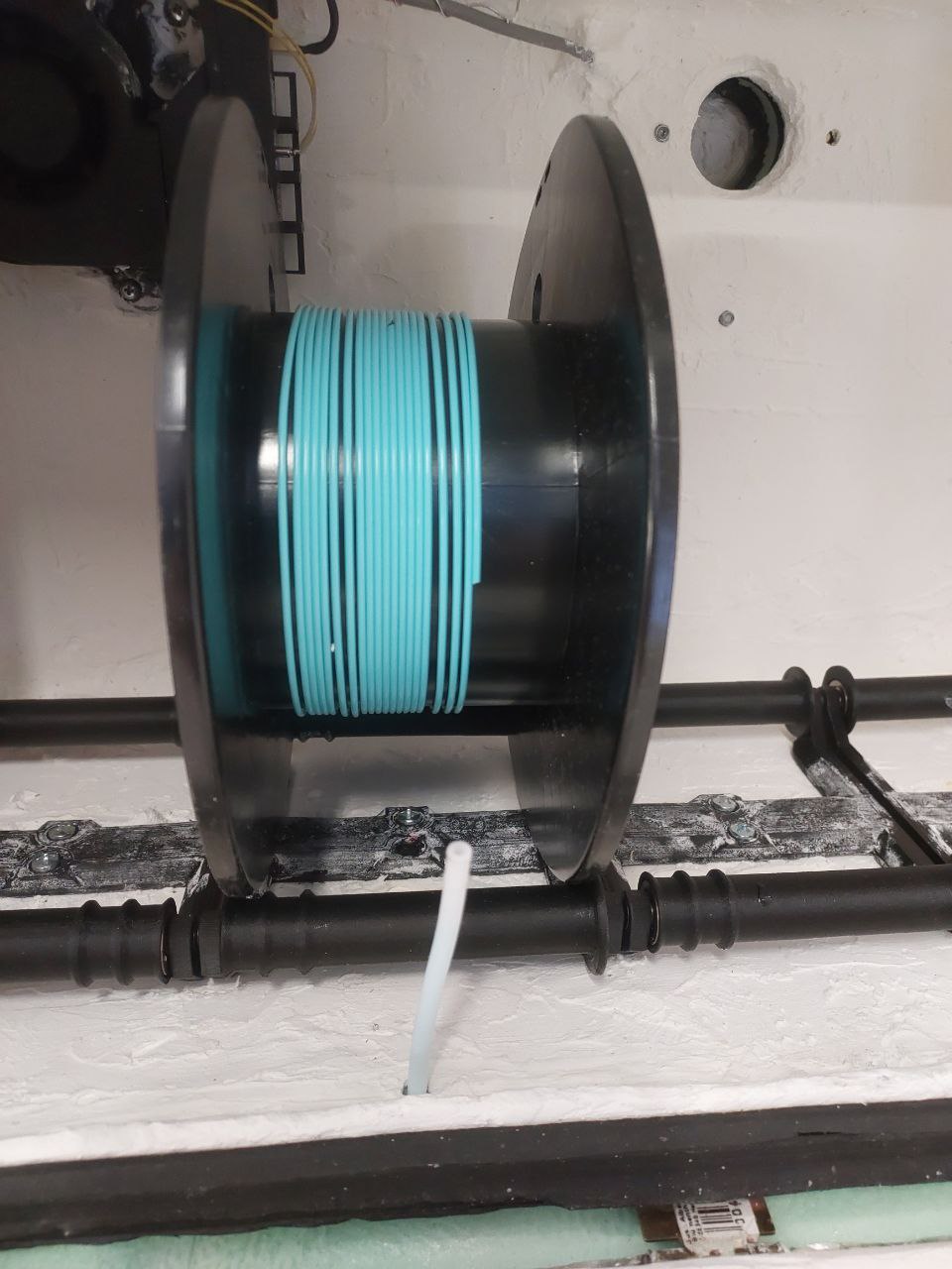

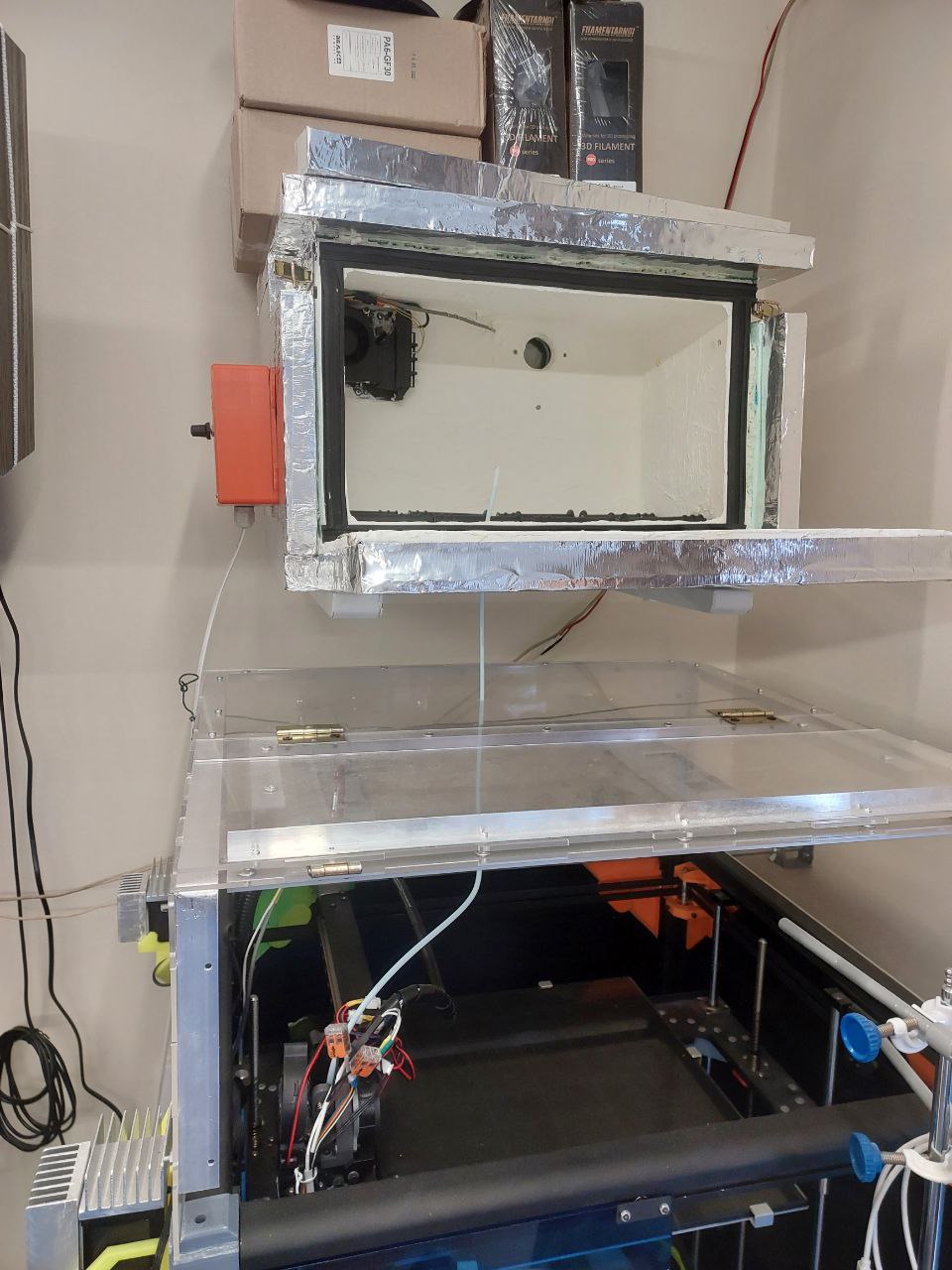

Could you post a photo of the setup, or a video from the feeder to the dryer?
And what retraction length do you have after printing?
Фото системы можно или видео от фидера до сушилки?
И какая длина отката после печати?
A photo so the whole path is visible, and what’s the tube length from the feeder to the dryer?
Фото чтоб весь путь был виден и какая длина трубки от фидера до сушилки?

Just 1 mm shouldn’t be getting stuck, maybe the tube is kinked somewhere?
1мм всего не должен застревать, может трубка где-то перегнулась?
It works pretty much in a straight line all the time, not far from home, at 1/4
Практически по прямой всегда работает, недалеко от дома, на 1/4

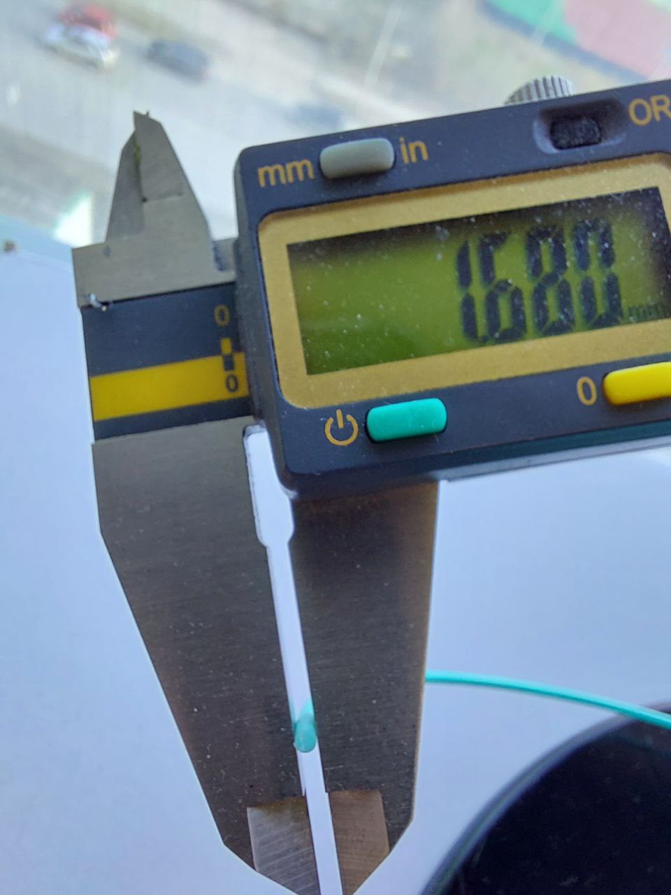

The only thing I can suggest is trying a tube with a larger inner diameter
There is 4x3 tube
Maybe it’s cracking and jamming itself?
It comes off the spool in loops, and in the tube it straightens out and cracks
But that’s just a guess

Yeah, like maybe it cracked diagonally and wedged itself,
but the previous times when I managed to push it through, the filament came out whole, not in pieces. :hot_face:
Then why doesn’t it crack during printing, that’s the main thing, but only at the end.. for now I’m chalking this up to one of those unexplained cases,
Other plastics never got stuck like that, all kinds of filament went through that throat, both smooth and composite
