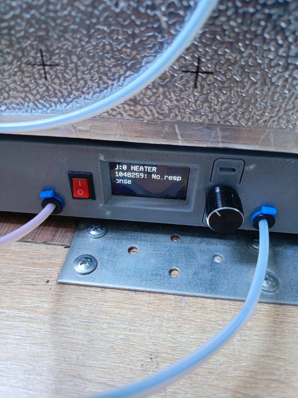

After a firmware update the dryer went into an error state and won’t reset with the buttons
I left the latest firmware on for now, but added the settings I had worked out through trial and error on the previous version. I put one spool in to dry as a test, and there were a couple of already dry ones in there too, and… apparently I messed up somewhere in the settings, because during the chamber heating this error popped up. Well, it popped up, fine, reboot and recheck the checklist, but… I still couldn’t get out of that error, so the dryer isn’t working now. I need to bring it back up and probably flash the old version again for now, but I can’t do that right now because a print is running

Errors are cleared by pressing the bottom button, but only after a reboot. That’s normal. You have to explicitly confirm that you’ve read it)
What was the error there? The heater wasn’t reaching the target in time?

Probably. I didn’t check, I started drying it and printing at the same time and then went back to dealing with work stuff.
About the button, I tried pressing all 3 buttons one by one, both after rebooting and with short presses, and even holding them for about 10 seconds

That’s strange. Anyway, I’ll check tomorrow
