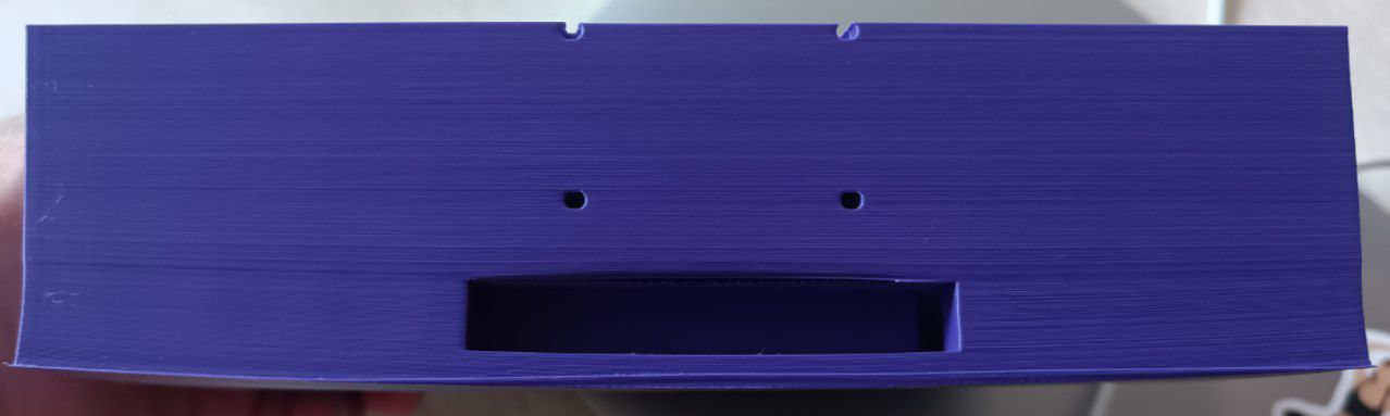

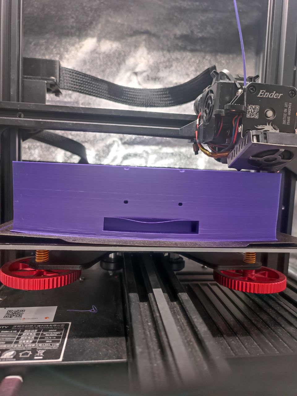

A large ABS part peels off the bed: clips, glass, and lowering speed
Somehow I forgot that big parts need clothespins around the perimeter when printing.
Should I try to save it somehow or just start over, what do you think?

Better to restart from scratch :cry: [iz chata]
Это лучше сначала😢 [iz chata]
It’ll only get worse. And ABS across the whole bed on a bedslinger… Even in an enclosure…
Should’ve at least gone with a composite one then…

And if you don’t want composite, then put glass on it and lower the acceleration.
Ну и если не хочешь композит - то клади стекло, снижай ускорения

You could also just lower the speed, but the general idea is clear.
You can try a .14 (.16) layer height and really lower the speed. And also let the chamber heat up before printing.

With clothespins and no glass, it might just warp the center :slight_smile:
The base needs to be more rigid, and for extra safety you can add clothespins too — then it’ll be the part itself that starts coming off! :rofl:
