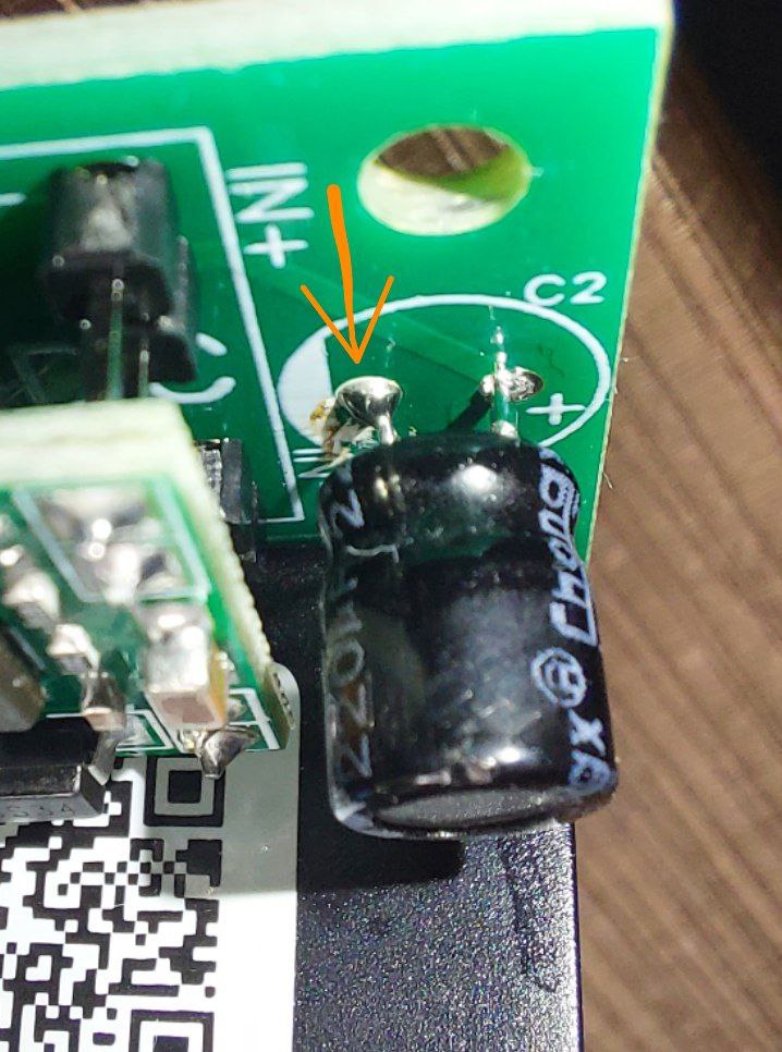

Problems soldering the negative lead of a capacitor on the board

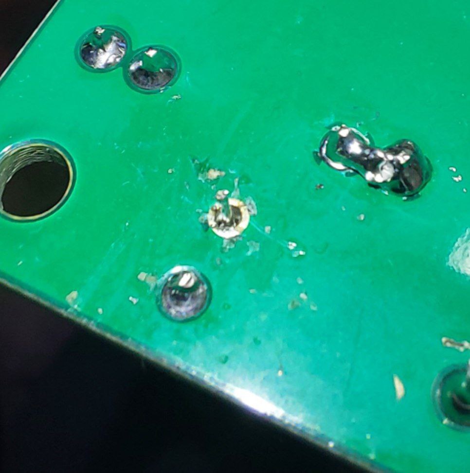

The negative lead on the capacitor from the bottom side just won’t budge at all. I’m afraid to heat it for too long, or the capacitor will melt..
I’m starting to think the diameter of the “negative thermal relief cross” is too small. We define it ourselves however we want, so it should be made a bit bigger, so less heat from the solder point gets dissipated into the board. Right now the “cross” is tiny and it’s like it’s trying to solder onto a solid plane, you have to heat it for half an hour.
The crosses need to be 2 times longer and 2 times narrower. Imhotep​:grin:
Something like on the encoder. The cross there is fine.
On the other side it only just managed to solder, there the heat wasn’t getting pulled away by anything, it stuck in one touch.

Strange. Mine soldered without any problems. Maybe the holes aren’t plated through. Or the soldering iron is weak. Or someone was stingy with the flux​:smirking_face:
The capacitor should sit on the board, not above it.

All the guesses are off, the soldering iron is T12, I set it to 300 degrees.
I tried different fluxes, even used acid
it’ll survive)))))
no one’s going to mess with it, it’s good enough as is )

Then the hole isn’t plated through.
Значит отверстие без покрытия.
Like a manufacturing bug?
As an option - it’s floating in a pool of solder there too.
and here the cross didn’t let it get properly tinned..

The capacitor should sit on the board. Why? I don’t know. But that’s how it should be​:blush:
Just saying, copper plating. No copper, no solder.

Here one thing rules out the other,
if you do it like that, then you’d only be able to resolder the capacitor onto the other side so you could solder it from the normal side, but it’s already done, it’ll stay like this

After drilling comes washing, degreasing, copper plating. Solder won’t stick to fiberglass.

ah, well then no, not our case. There was solder in the hole. I would’ve noticed right away if the solder point wasn’t plated. Everything looked fine,
maybe if I set the soldering iron to 350 degrees it would’ve grabbed. But all the other points soldered in one touch at 300 degrees, not a single problem except a few negative points.. I’m afraid of melting the capacitor, and if, like you say, it has to sit right on the board - then soldering at 350C gets really sketchy.

Then there’s only one option. You just got unlucky.
