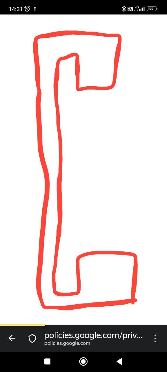

I made guide rails — you slide the board in
Something like this
Я делал направляющие - задвигаеш плату
Типо того
Corner brackets screwed into the enclosure body work, but they only hold the board at the perimeter, so if the PCB is thin it can still flex in the middle. A better approach is what was mentioned about guide rails: print shallow channels on two opposite walls and slide the board in. That gives full-edge support without needing tabs on the PCB itself. Just leave tolerance for the board thickness and a small lip at the top so it can’t lift out. A dab of hot glue or a screw-down retainer strip keeps it from sliding back.
