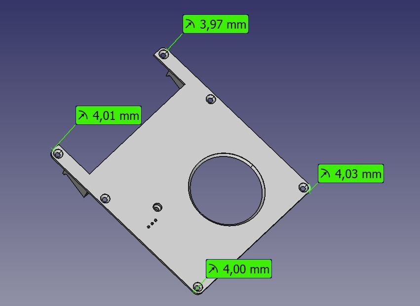

Most likely that won’t help. I mostly edit STEP files in FreeCAD, and it’s a finicky piece of software. Especially if the model wasn’t made rigorously enough.

Yeah, FreeCAD is quirky, but here it’s more a question of why the model ended up like this in the first place. When it’s made like that, it’s really inconvenient to keep refining it.

Can’t check right now, but I know for sure how I usually design, and there are no unique fillets there — usually that’s a post-operation applied to everything at once, and if it’s in a sketch, then it’s just one operation for the corners. I’ll compare it, I’m curious myself, but it’s weird)

That’s the model precision when saving and the model precision when recognizing/importing. I’ve had cases where you save a part as STL in KOMPAS at low resolution and polygons are visible on the model.

STEP stores boundary-representation geometry, not a polygon mesh, so faceting is usually just display tessellation rather than the STEP data itself. If FreeCAD looks polygon-like after import, check the tessellation/display settings and make sure the file wasn’t converted through STL. For editing failures, the usual suspects are tiny gaps, sliver faces or fillets that prevent clean feature recognition; healing/checking the solid before adding the support protrusion may help more than changing CAD tools.
