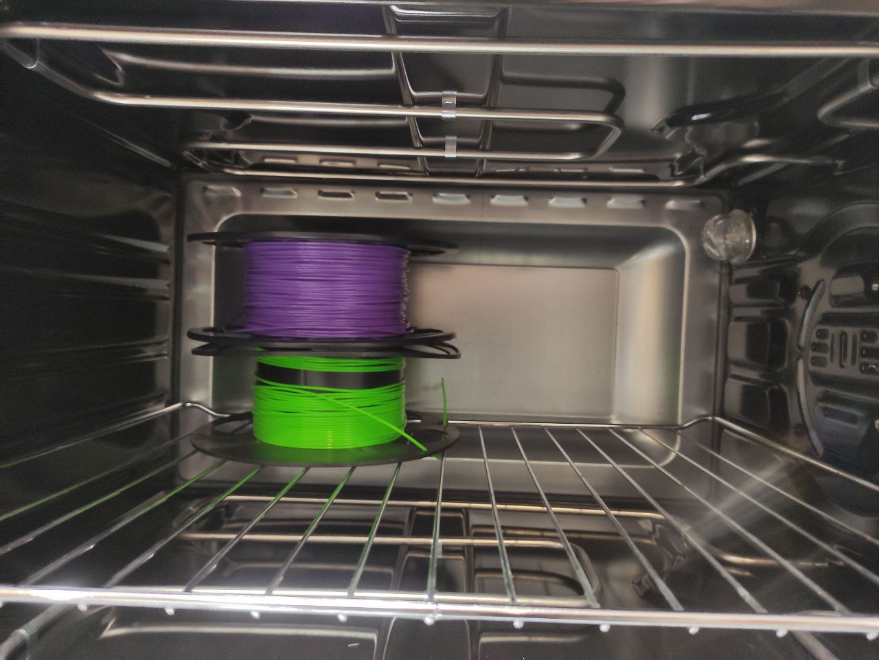

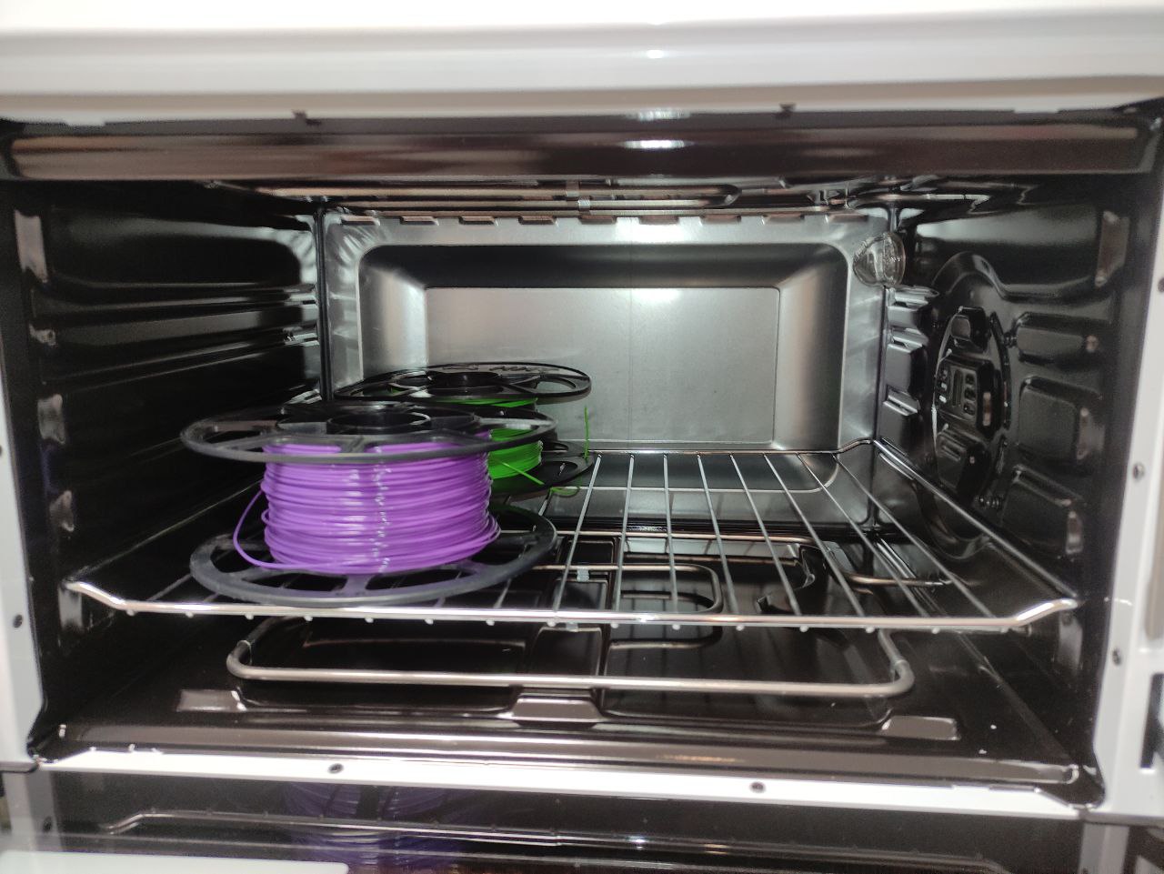

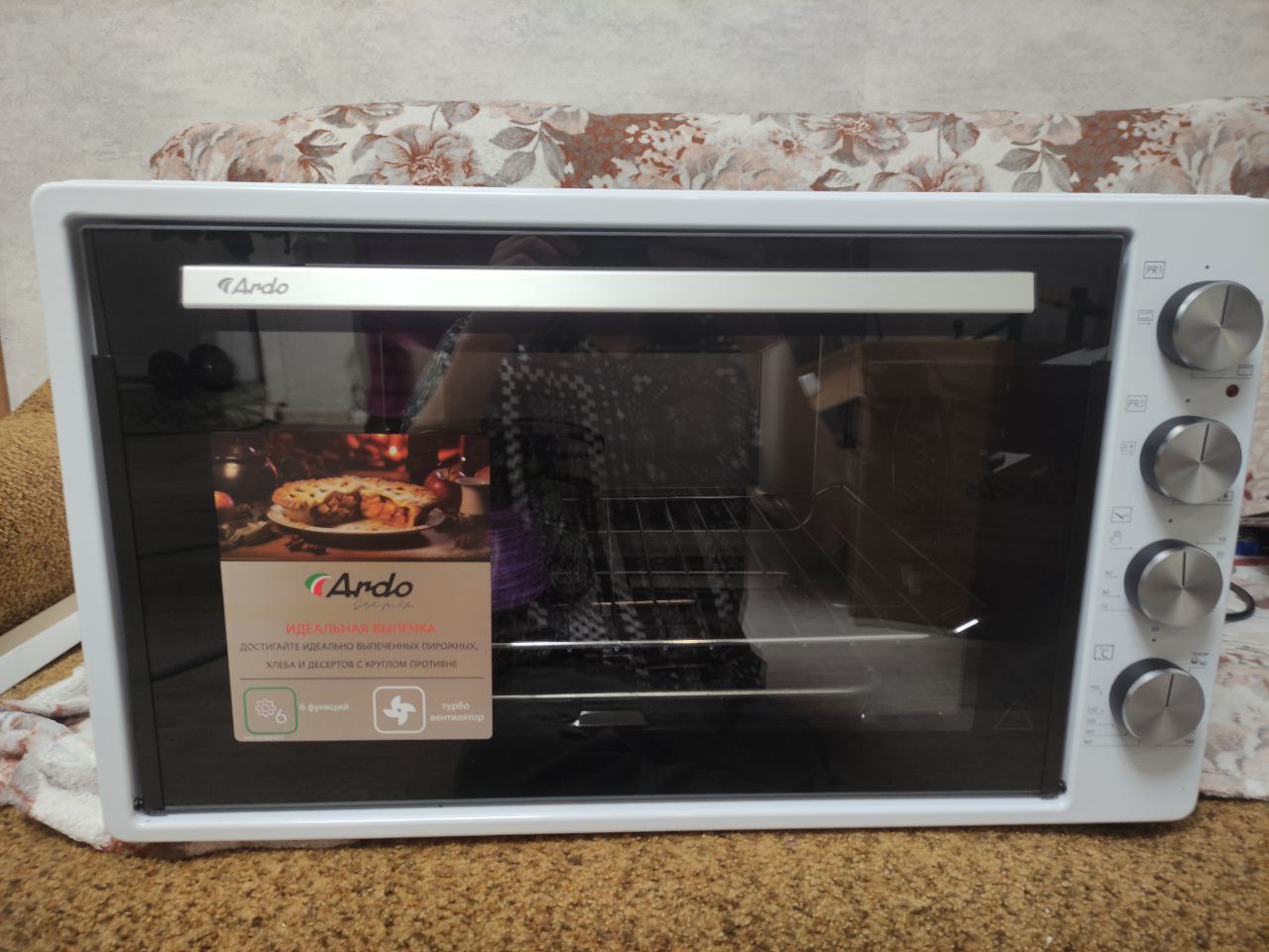

I bought an oven for terylene and nylons

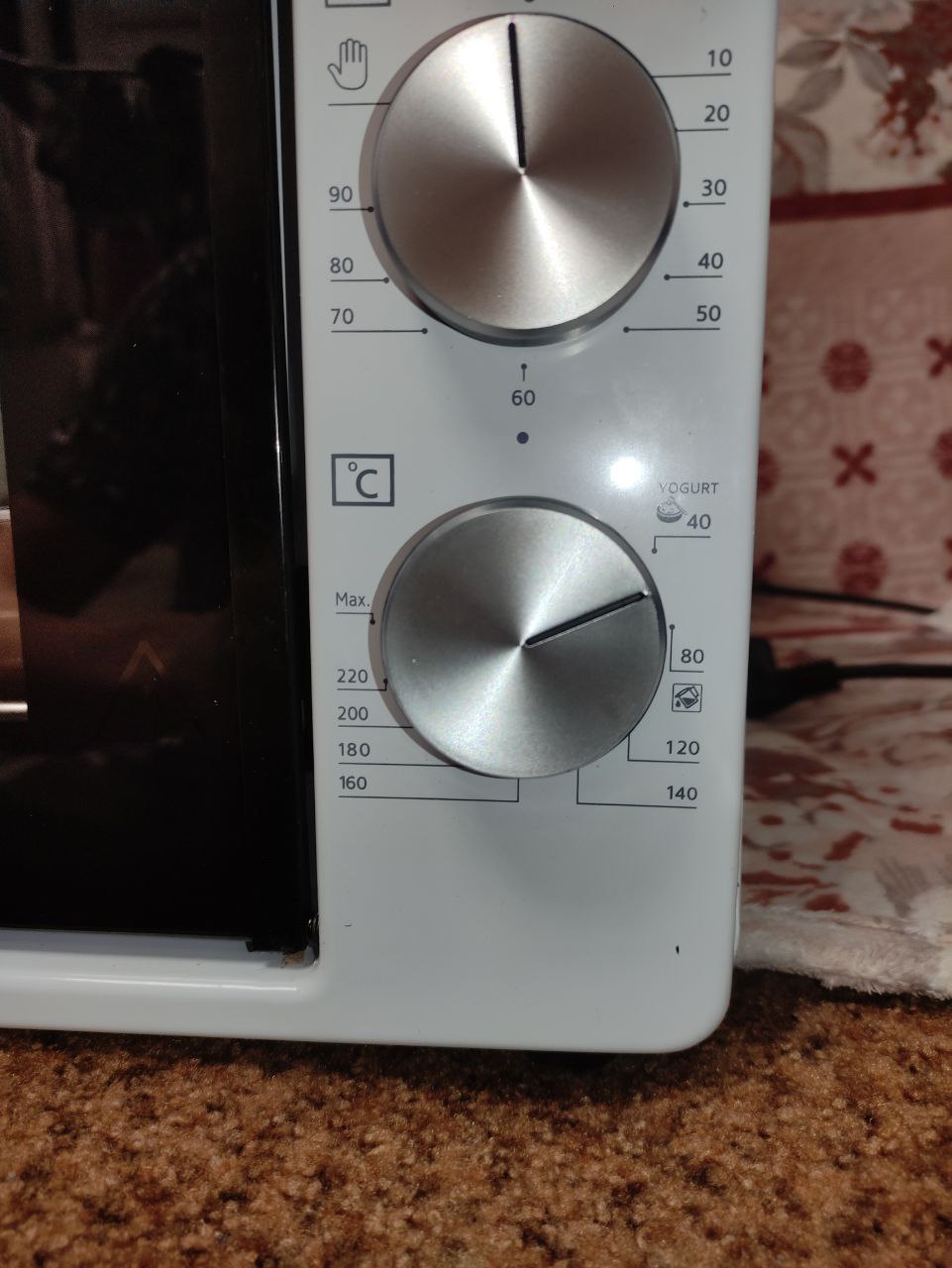

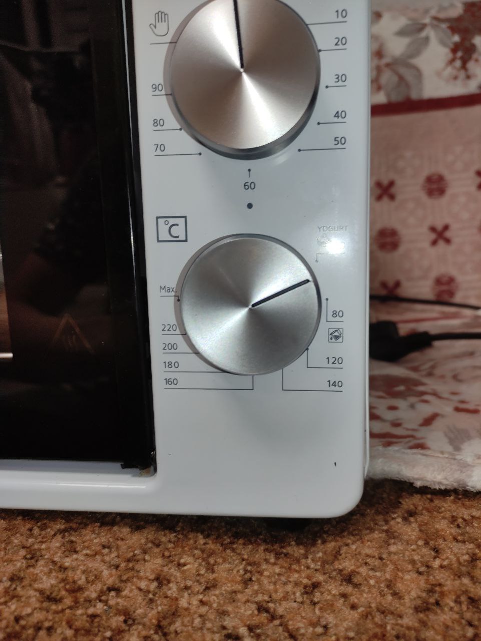

It’d be a good idea to also check how it actually heats. Chinese 100 degrees can easily turn out to be a whole 140°C.
Не мешало бы еще проверить как она греет на самом деле. Китайские 100 градусов легко могут оказаться целых 140°.
You could make a dryer out of one like this if you install a proper PID controller with a thermocouple.
Stock, it can easily overshoot by +20-30.
