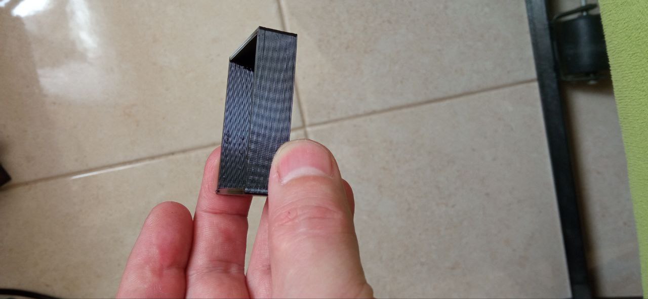

I just can’t beat this. I replaced the gears in the extruder, put on new belts. Same thing at speeds from 30 to 200 mm too. Maybe I should try throwing it out the window? Can anyone suggest something? What else can I do? The printer had been idle for a month. Started a print and then this :sob:

You shouldn’t have replaced them, you should’ve checked them for eccentricity. You’ve probably got something up with the BMG-style ones, right?

Could this be ringing? Looks like the belt pitch is visible, but there’s something else layered on top too.

Yeah. I thought I’d replace it and be golden

Check that everything is tightened, from the nozzle all the way to the carriage mount.
