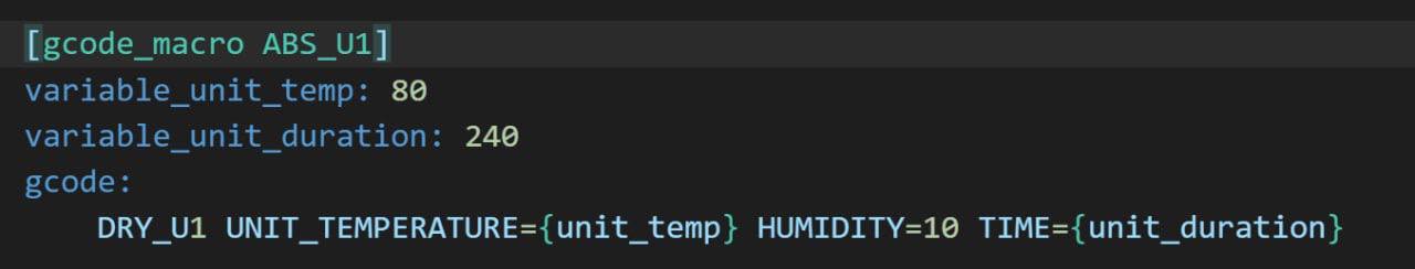

variable_unit_duration: 240
Can you tell me what unit 240 is in?
Подскажите, у 240 какая единица измерения?
Minutes, but they’re not enabled — I forgot, then couldn’t be bothered, then skis, slopes… I’ll polish it up.
минуты, но они не включены, я забыл, потом забил, потом лыжи, горки… Допилю
So it dries until I turn it off?
То есть сушит, пока не выключу?
I can’t say right now, I’ll check later
added

looks like that’s it)
save the old macros, apply the new ones, pull over whatever you changed in the old ones like angles and deltas, and test it
