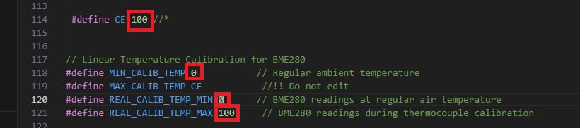

IMO, before the BME calibration procedure on 0.5.6, you should first set both minimum constants to 0 and the maximum ones to 100 (or 110, whatever you need). And only then start comparing with the probe. Only in this case will the data come through as-is, without calibration corrections. After the procedure, you can change them to your own values.

So before the first calibration, set those values, and after reaching the temperature, put the thermocouple value into the #define REAL_CALIB_TEMP_MAX field, am I understanding that right?

Of course, those are the values without calibration and correction; you need to get the difference in the readings and enter it there.

After calibration, do the minimum values stay at 0?

Zeroes don’t make much sense, since the room isn’t at 0, so it’s better to set the actual room temperature.

#define CE 100 - set either 100 or 110
#define MIN_CALIB_TEMP - current room temperature
#define REAL_CALIB_TEMP_MIN - current room temperature taken from the bme
#define REAL_CALIB_TEMP_MAX - before the first calibration set it to 100 or 110 (same as in define CE), then change it to the value from the thermocouple

You can calibrate the minimum too, or at least just fill in the room-temperature values there afterward (because anything below that doesn’t matter to us) for the bme and the probe as they are initially before turning on the heater. Mine differ by a couple of degrees. At the low end, my bme shows a bit more than the probe, and at the high end, quite a bit less.
