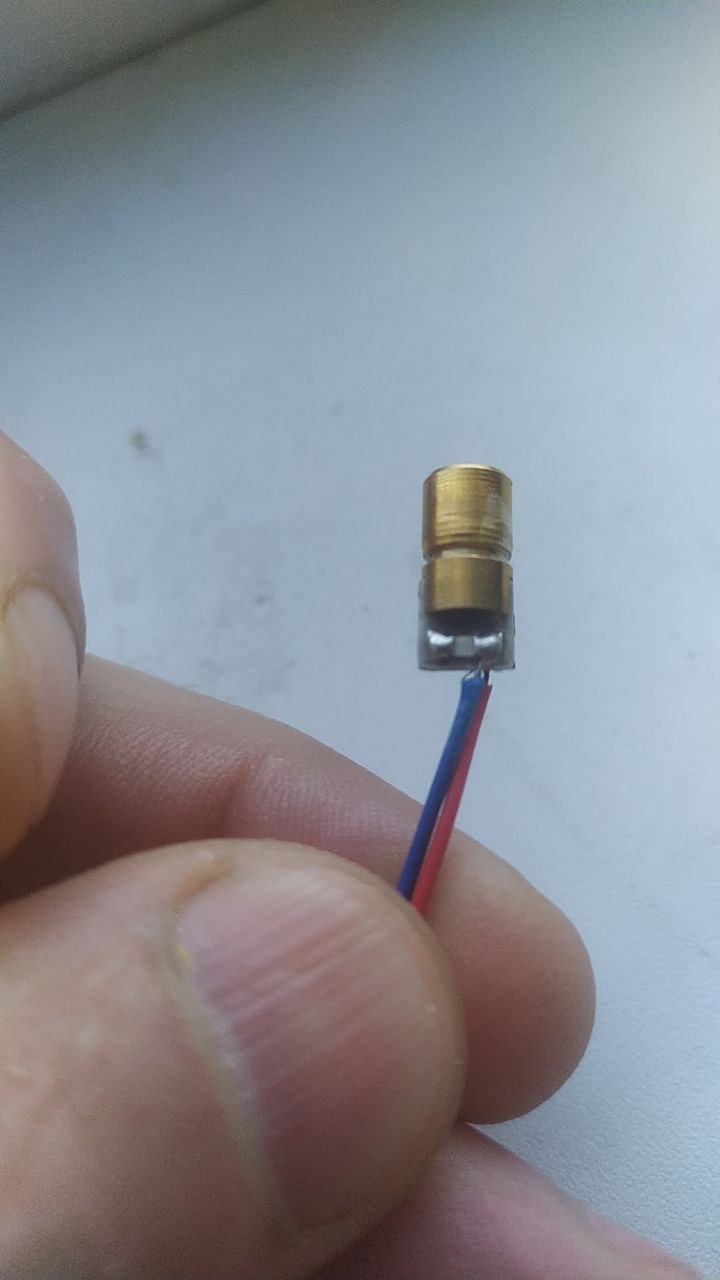

How to power a laser from a power bank if it shuts off due to low load
Guys, anyone here know their way around electronics?
I need to hook up a laser like this to a power bank.
It works fine from a phone wall charger, but with power banks, on one it runs for a few seconds and then the bank shuts off, and on another it shines really dim.
Maybe someone can suggest how to fix this?

Looks like you need a load resistor. The load is too small for the power bank, so it shuts off.
Нагрузочный резистор похоже нужен. Для повербанка слишком маленькая нагрузка и он отрубается.
Yeah, I was thinking that too. Just stick it in parallel?
тоже об этом думал. Параллельно воткнуть?

Got it, I’m just not very strong in electronics when it comes to picking component values.
понял, просто я не селен в схемотехнике, в плане подбора номиналов.
It’s just Ohm’s law :person_facepalming: 7th grade physics
You need something around 200 ohms.
That should be enough for the power bank to think it’s charging something.
It is 5 volts, right?
