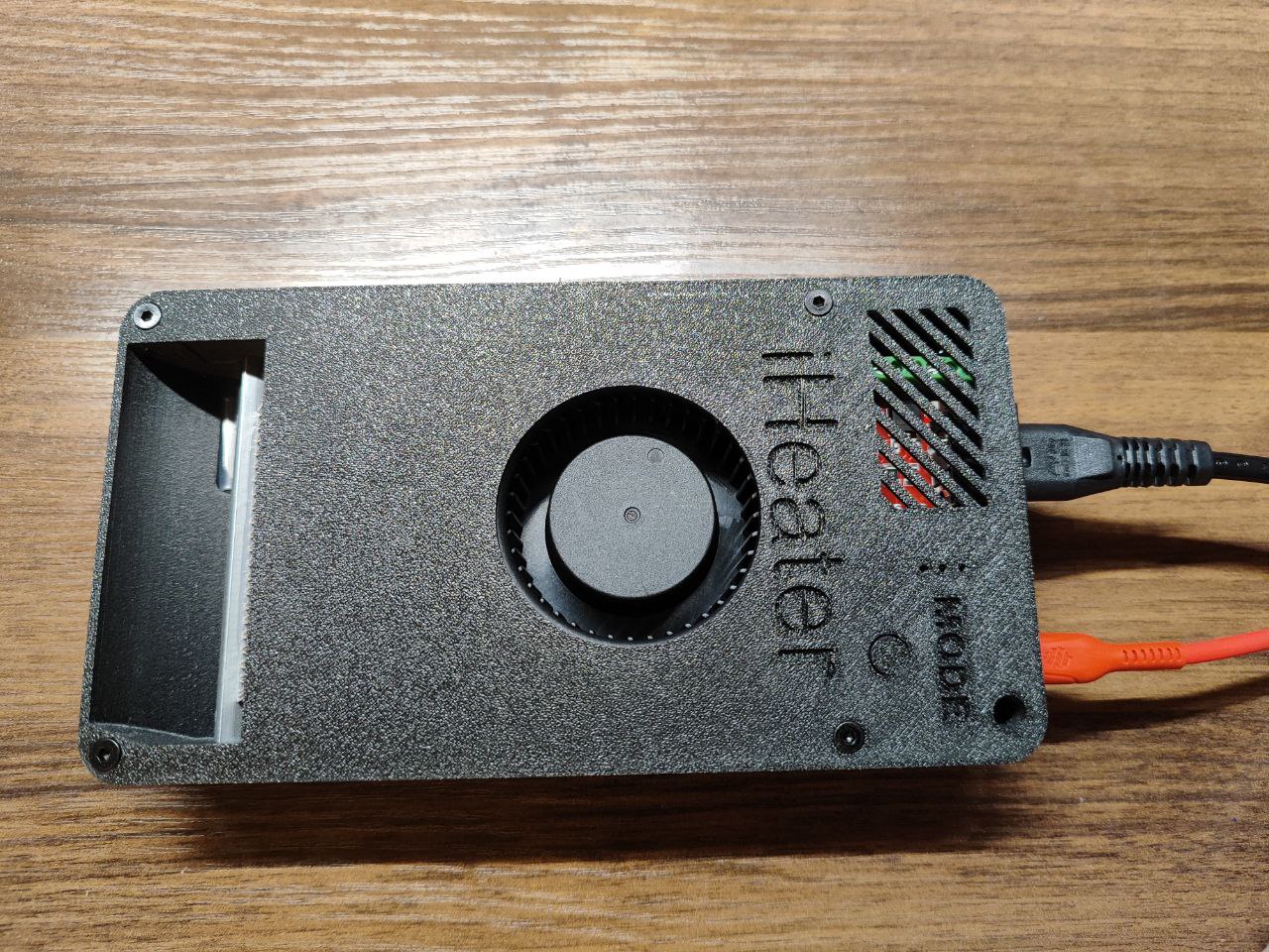

So, here’s a quick review of probably the neatest, most well-engineered, and most user-friendly active chamber heater solution for any printer on the market:
  1. The package was, as always, packed отлично, everything arrived without any issues via Yandex. Ordering from the store has become super convenient — clicked, paid, got a delivery notification, received it :slight_smile:

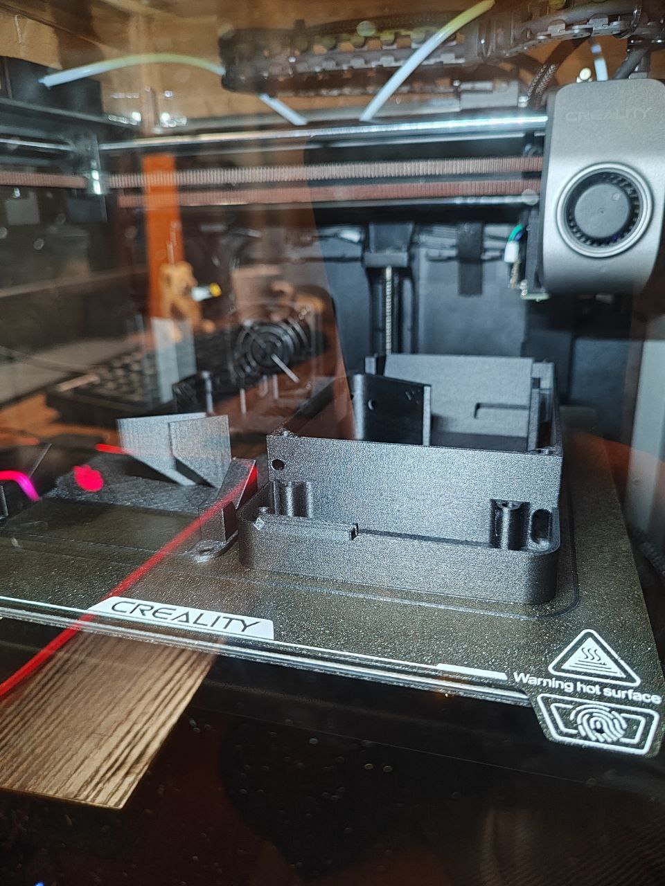

  2. The CAD model is made well, easy to tweak if needed (I slightly changed the area near the air outlet, moved the deflectors onto the cover, and added chamfers / spots for heat-set nuts), and the cable management is thought out really well. Printed everything without supports from filamentarno total cf-5 with a flow limit of 8 mm3, no problems at all.

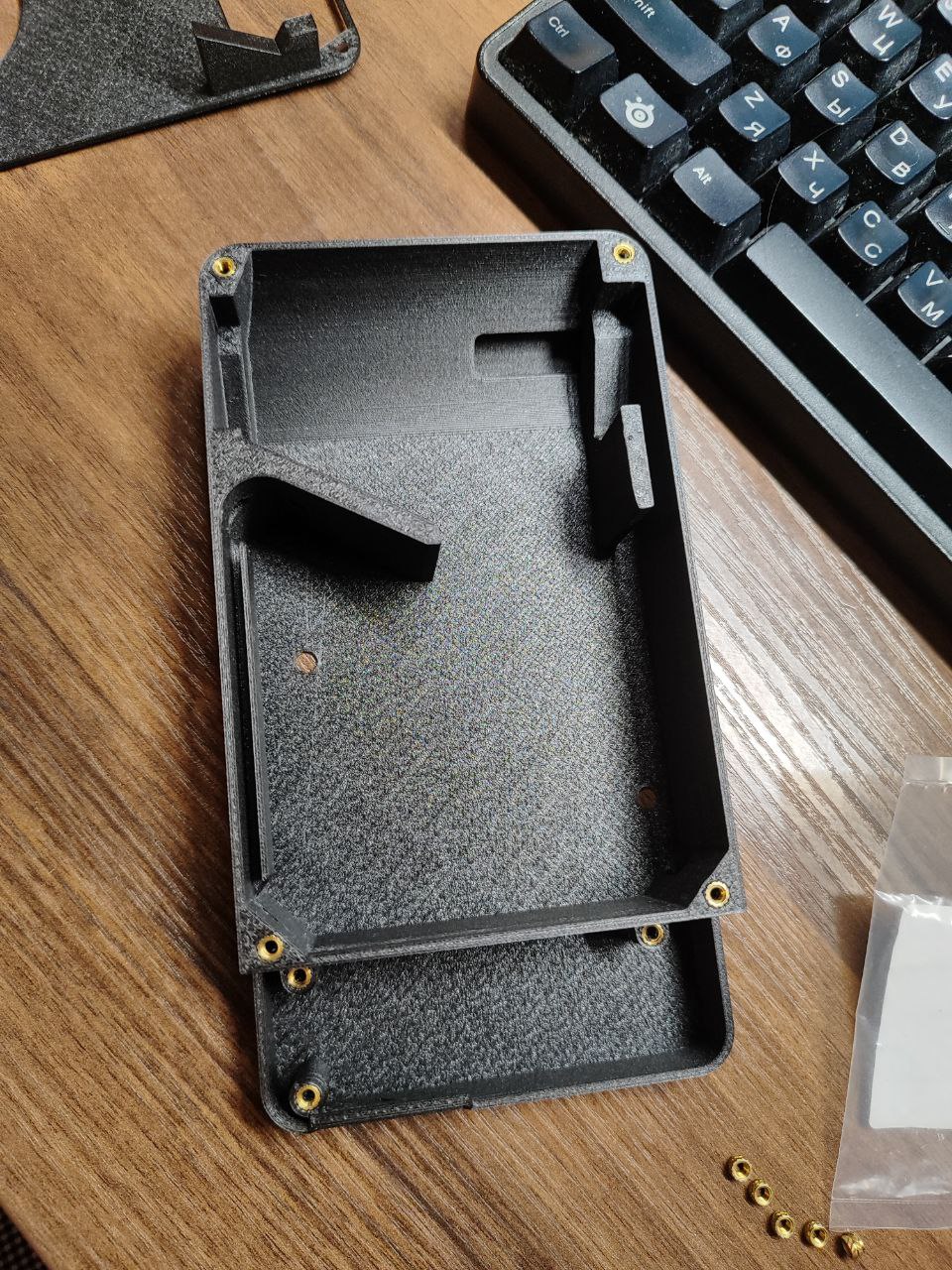

  3. Assembly is dead simple, the fastener list is small and nothing exotic. I ended up using 5 M3x6 countersunk screws for mounting the cover, 2 M3x6 standard-head screws, and 2 M5x4 countersunk screws for mounting the fan (not my best decision, they stick out a bit — better to use proper fan mounting screws like Ruslan originally planned). And in my case, heat-set nuts of the appropriate sizes, though you can do without them too — depends on the material the housing will be printed from.

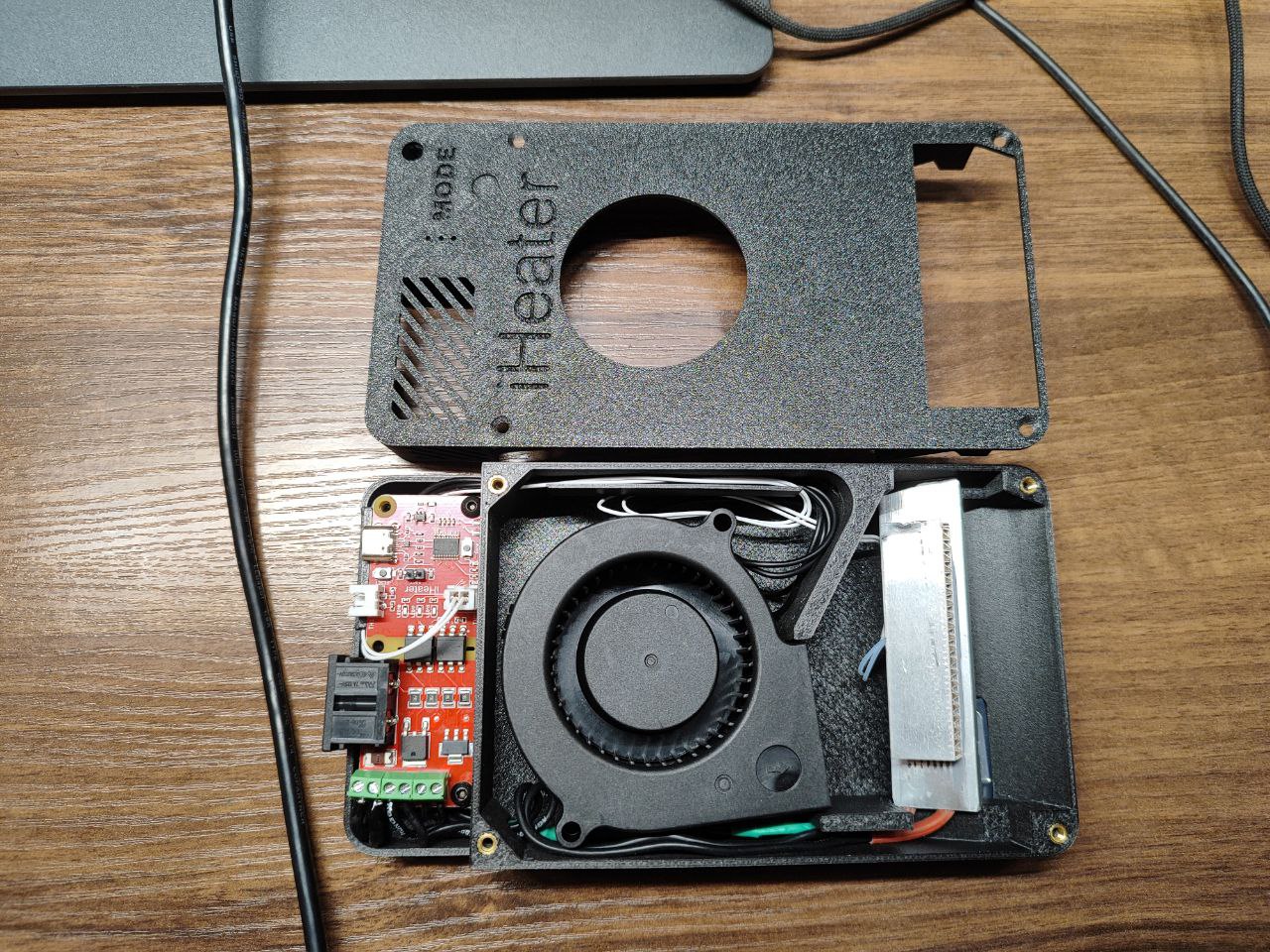

  4. The assembly and flashing of the Catapult is described separately for total newbies like me, I was doing it for the first time and everything went smoothly. For those suffering with “optimized” printer motherboards (like the K1 series), I recommend making a bootable Ubuntu flash drive, putting the same Klipper your printer uses onto it, and building the firmware that way. After that, you just need to drop the config onto the printer and plug the board into a free USB port.
  5. Same story with flashing Klipper through Catapult — the instructions are more than detailed enough. It was my second time doing it, but I still used them, and again it all went almost without issues (aside from missing write permissions to the USB device, but that’s more of a Linux thing).
  6. For those to whom points 4 and 5 don’t apply, there’s a standalone mode. Haven’t tested it yet, but its presence adds a whole new level of accessibility for printers with “too well optimized” hardware and for situations where messing with the printer’s factory configuration isn’t possible for some reason.

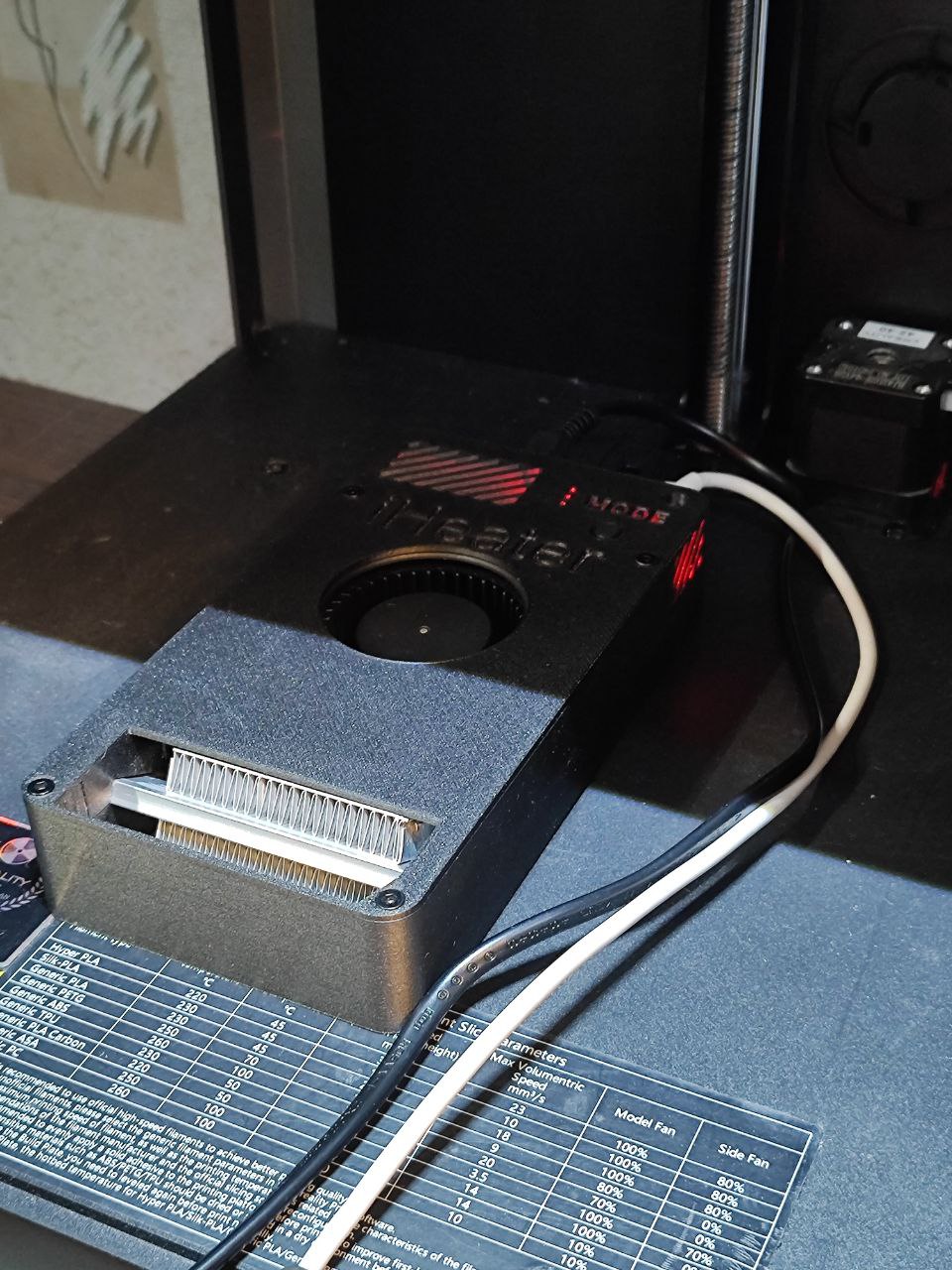

  7. Subjectively, the looks turned out pretty good, and the dimensions are optimized as much as possible, which is also nice. It’ll fit into most printers pretty much anywhere. For now I temporarily put it under the bed, but overall I think the idea is visible in the renders.
  8. The integration with the printer is awesome — I personally hooked up the printer’s stock sensor in just a couple of minutes to detect the air temperature at the top of the chamber. Combined with the device’s own remote sensor, you can set up some really smart chamber heating control schemes, not to mention that if you want, you can also take bed temperature and other stuff into account. Overall, Klipper is awesome. Or you can just do nothing, use the standard config, and it’ll still work pretty well :slight_smile:
Overall, this is my first impression, and it’s a positive one — respect to the project authors! Of course, there’s still a lot of testing ahead, but the current level of polish is already at a pretty solid point.
Probably sounds like an ad, but it’s not. It’s open source! :^)

И так, экспресс обзор на наиболее аккуратное, технологичное и удобное решение для активной термокамеры любого принтера на рынке:
  1. Посылка как всегда отлично упакована, все доехало без проблем Яндексом. Заказ в магазине стал супер удобный - нажал, оплатил, получил уведомление о доставке, получил :slight_smile:
  2. CAD модель сделана хорошо, легко дорабатывается при необходимости (я немного изменил область около выхода воздуха, перенес дефлекторы на крышку и добавил фаски/места под вплавляемые гайки), прекрасно продуман кабель-менеджмент. Печатал все без поддержек из filamentarno total cf-5 с ограничением по расходу 8мм3, проблем никаких не было.
  3. Сборка элементарная, номенклатура крепежа небольшая и не специфическая. У меня вышло 5 винтов м3х6 с потайной головкой для крепления крышки, 2 винта м3х6 со стандартной головкой и 2 винта м5х4 с потайной головкой для крепления вентилятора (не самое мое удачное решение, немного выпирают, лучше взять специальные винты для крепления кулеров как планировал Руслан изначально). Ну и в моем случае вплавляемые гайки соответствующих размеров, но можно и без них, зависит от материала из которого будет напечатан корпус.
  4. Сборка и прошивка катапульты описана отдельно для хлебушков вроде меня, делал первый раз, все прошло без проблем. Для страдальцев с “оптимизированными” материнскими платами на принтерах (типо к1 серии) рекомендую сделать загрузочную флешку с образом убунты, запулить туда тот клиппер, который использует Ваш принтер и собрать прошивку таким образом. Далее просто останется закинуть конфиг в принтер и подключить в свободный USB разъем плату.
  5. Аналогично с прошивкой клиппера через катапульту - инструкция более чем подробная, делал во второй раз, но все равно воспользовался, аналогично прошло почти без проблем (не считая отсутствия прав на запись в USB устройство, но это больше относится к линуксу).
  6. Для тех, для кого 4 и 5 пункты не актуальны есть режим самостоятельной работы. Пока не тестил, но его присутствие добавляет новый уровень доступности для принтеров с “слишком хорошо оптимизированным” железом и ситуаций, когда вмешиваться в заводскую конфигурацию принтера по каким-то причинам нельзя.
  7. Субъективно внешка получилось неплохой, габариты максимально оптимизированы, что тоже хорошо. В большинство принтеров залетит куда угодно, я пока временно поставил под стол, но в целом на рендерах, думаю, видна задумка.
  8. Интеграция с принтером это офигенно, лично я спокойной за пару минут прикрутил штатный датчик принтера для определения температуры воздуха вверху камеры. В совокупности с выносным датчиком самого устройства можно мутить грамотные схемы управления прогревом камеры, не говоря уже о том, что при желании можно учесть и температуру стола и прочее. В общем клиппер это крутая тема. Ну или можно просто ничего не делать, использовать стандартный конфиг и все тоже неплохо будет работать :slight_smile:
В общем это первое впечатление и оно положительное, респект авторам проекта! Разумеется, еще предстоит много тестов, однако текущий уровень проработки проекта уже на неплохой отметке.
Наверное, звучит как реклама, но это не она. Это опен сорс! :^)
