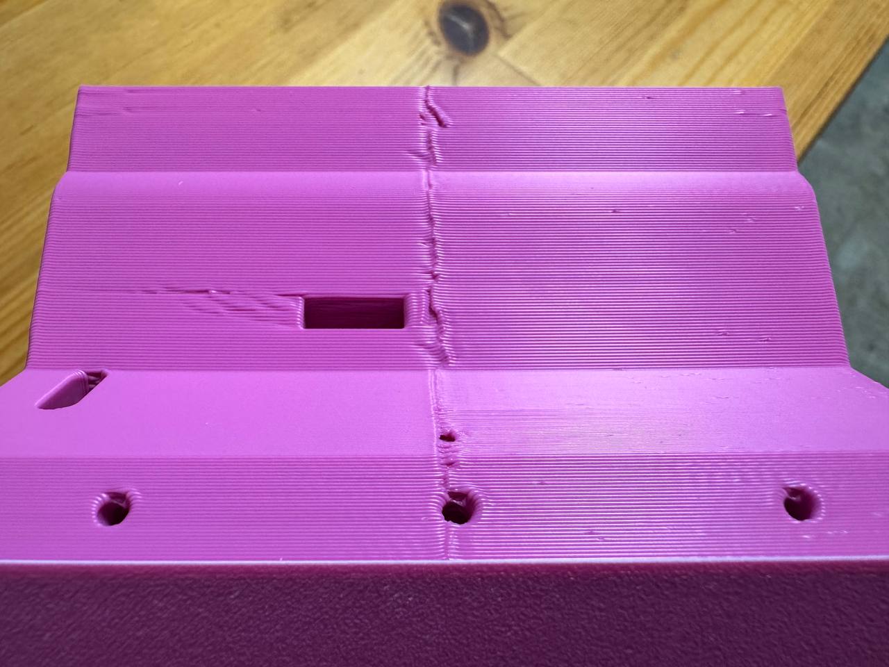

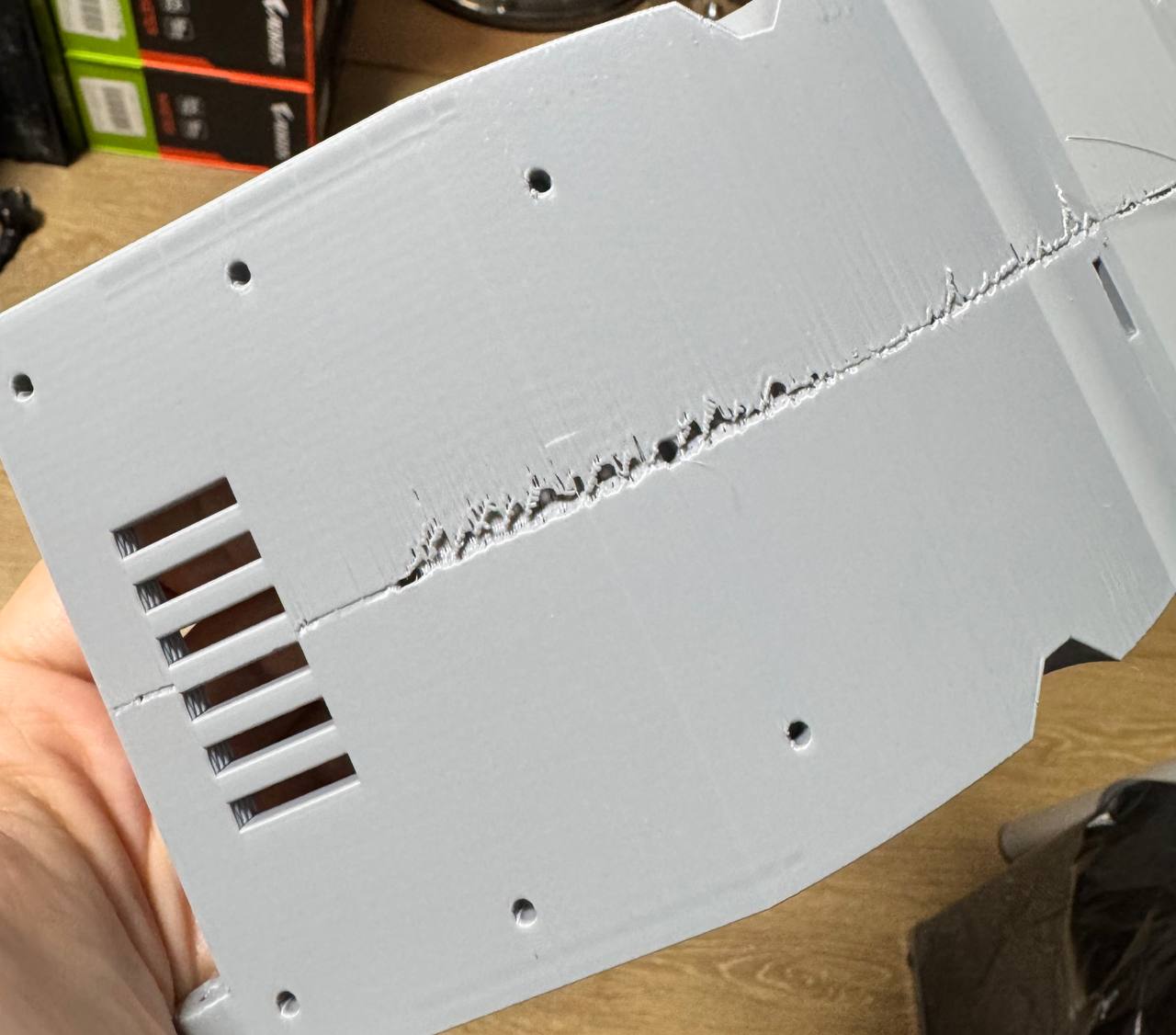

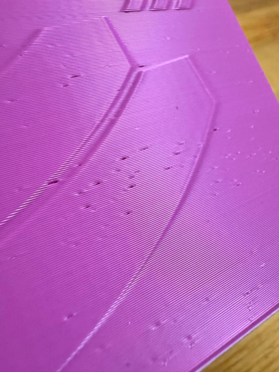

Bubbles, seam, and ABS print settings on Qidi Q1
Help me out) 1 perimeter, 0.6 nozzle, pushing line width 0.62, 15% rectilinear infill, 250 degrees, flow 0.95, retraction 0.4, PA 0.028, what else should I tweak…

So those bubbles (in the last one) are either filament like that with an air channel in the center, or retractions (maybe too fast, you didn’t write the speed)
And the seam — PA and retractions. But overall it’s most likely temperature. What’s the flow rate?

Temp 250, flow rate 20, speed 100
I already tried several different plastics, it’s not the filament, calibrated PA is 0.028

What hotend or printer is it?
Isn’t 20 cubic mm/s a bit much?)
You could raise the temp

It showed speed 100, max it’s pushing is 10–14 in the web UI

I print ABS at 280 (K1 Max)

Yeah I did that too, then I made a temp tower, and 250 looked fine there… Just cranked it up to 270 degrees now, let’s see the difference, everything else stayed the same
